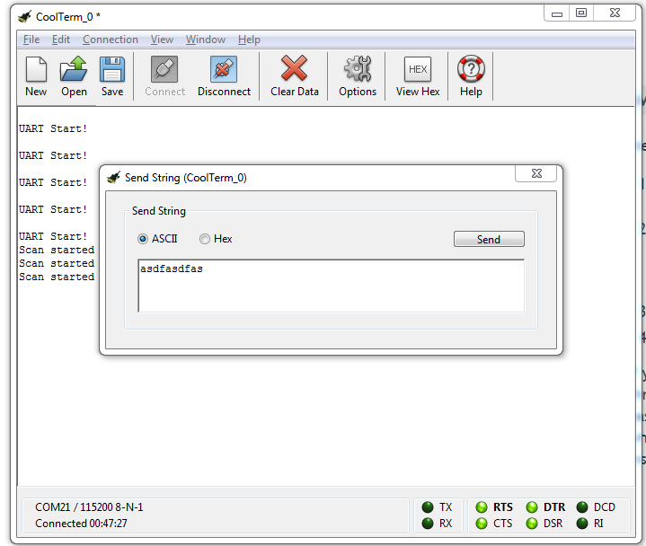

image descriptionhow to create custom service in order to send dummy message, not from the console, I have to make one char arr[]="hello" this is a fixed string, then where i have add this string as data and what are the parameters are required to create simple custom service? please tell me the stepwise procedure to do this.
I don't want to send the data by this type of window as a shown in the below picture and also by mobile app.

  • Ble_app_uart is working fine but I don't want to send through the console, it should be programmatically I want to create one char array and directly I want to add this string to the data.
