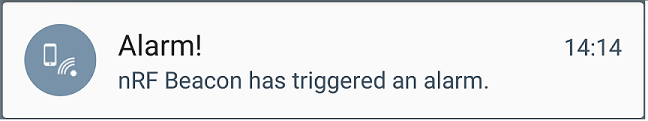

  • Make sure that the phone is not in silent mode. You should also get a notification like this when the alarm is triggered:
    image description
