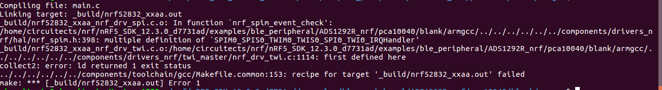

I having an nrf52832 board and using gnu arm, nrfjprog to program the device. i reading data from two different sensors using spi and TWI in two different codes. now i need to combine the two project to one, so i tried to add the twi to the spi code but some error as shown below comes up. i have edited the makefile and sdk config files but not sure weather its correctly done.image description

    i.e you have a multiple definition of
    SPIM0_SPIS0_TWIM0_TWIS0_SPI0_TWI0_IRQHandler
    You should look in your code for this function, as you have defined it twice, or somehow included implementations of it twice
    Then probably change your code so that the same function in the two differences has different names, and adjust your setup code accordingly to use the new function names.
    BTW. This is development 101, its not specific to the Nordic products / SDK / API or toolchain
  • SPI and TWI are shared resources. You cannot use SPI0 at the same time with twi0. You can use spi0 and twi1 or vice versa.

    #define SPI_INSTANCE  0 /**< SPI instance index. */
    static const nrf_drv_spi_t spi = NRF_DRV_SPI_INSTANCE(SPI_INSTANCE);
    or
    #define TWI_INSTANCE_ID     0
    static const nrf_drv_twi_t m_twi = NRF_DRV_TWI_INSTANCE(TWI_INSTANCE_ID);
    in your code to use another instance, e.g. TWI_INSTANCE_ID 1 in addition to enabling this in the sdk_config.h file.
  • Thank you so much Nguyen Hoan Hoang, it did solve my issue.
