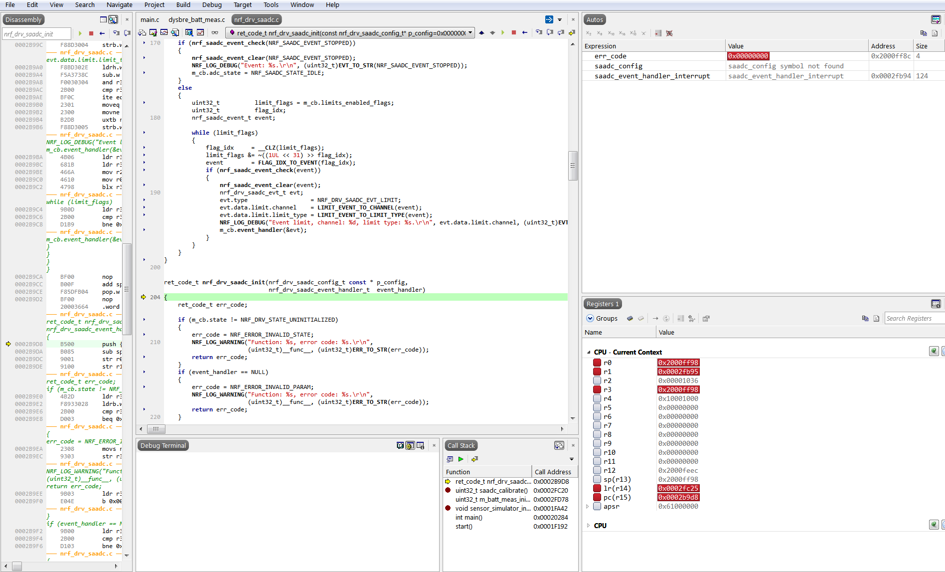

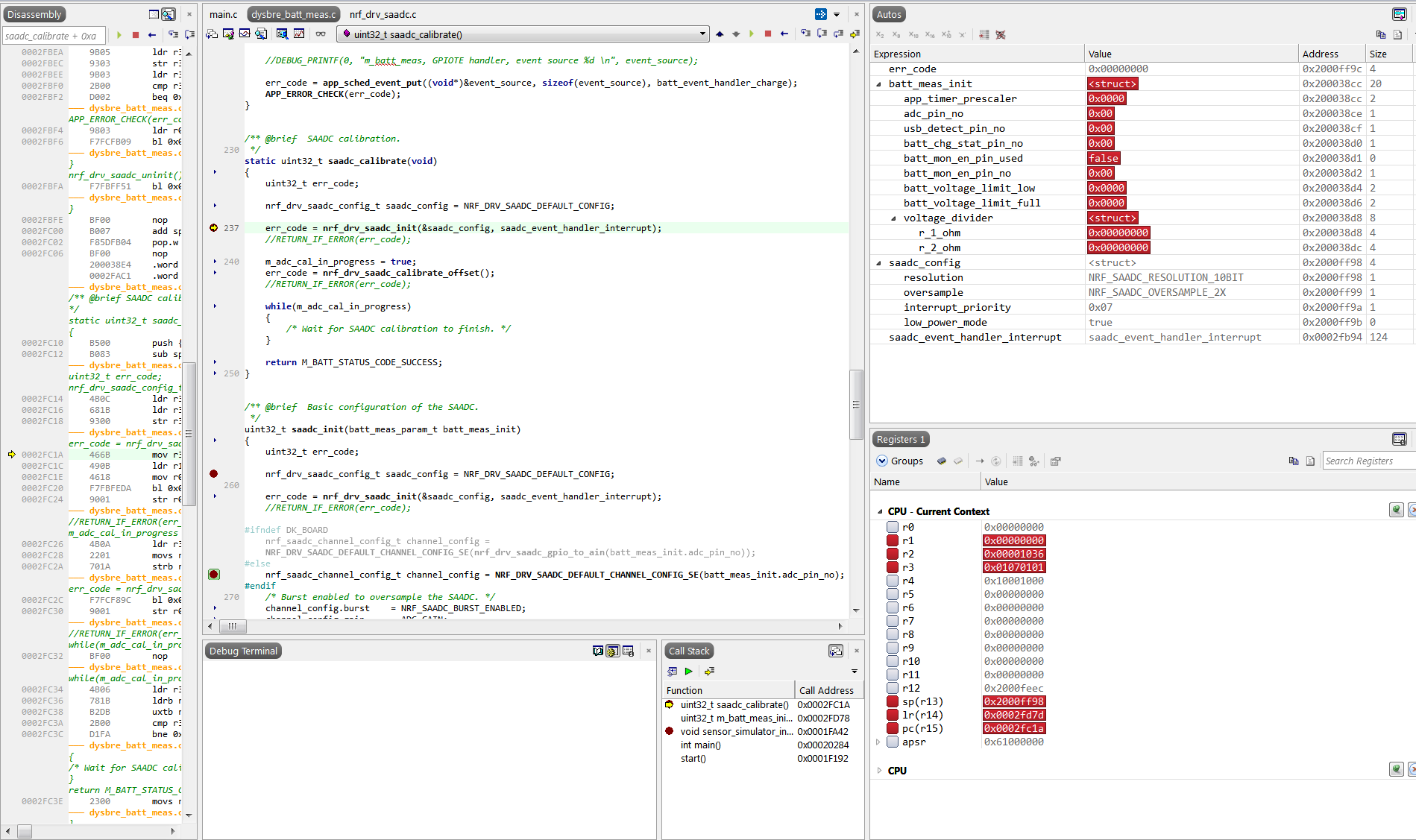

  • What do you mean by "SAADC seems to lose the pin referece to VDD." ? I don't see anything wrong in the images. After you call nrf_saadc_channel_config_t channel_config = NRF_DRV_SAADC_DEFAULT_CHANNEL_CONFIG_SE(batt_meas_init.adc_pin_no), pin_p in channel_config is set to NRF_SAADC_INPUT_VDD.
