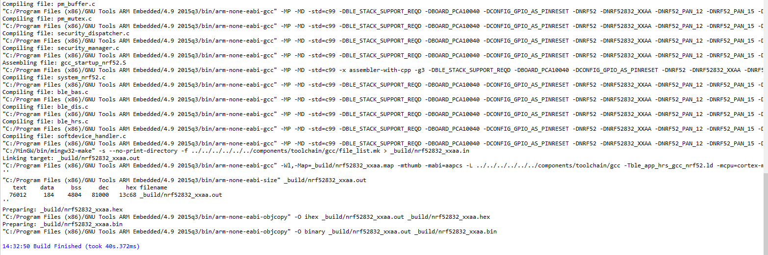

I've been following the tutorial for Eclipse IDE setup devzone.nordicsemi.com/.../, but I'm currently stuck at the auto-discovery. I've been able to compile, build and program the blinky and the ble_apps_hrs_pca10040_s132 example succesfully, but still functions like APP_ERROR_CHECK() are red underlined, because the auto-discovery is only working partially I assume.
I do get the verbose output, so the build command: C:\MinGW\bin\mingw32-make.exe VERBOSE=1 is working. This is the output I get:

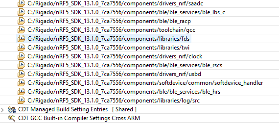

But if I look at for example main.c's Properties -> C/C++ General -> Preprocessor Include Path -> CDT GCC Build Output Parser, there are no Pre-processor Symbols added like in the Development with GCC and Eclipse.pdf Troubleshooting Guide.
image description
I use SDK 13.1, so the default makefile.common found under s132/armgcc/ is equal to the fixed makefile.common added to the Tutorial. I've also compared the makefile from the SDK13.1 example with that of the Tutorial application, the only difference I could find where optimization level for the CFLAGS and the added -g3 flag at the ASMFLAGS in the example project.
