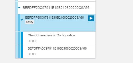

I am attempting to write to multiple CCCD handles in a service as a central with no luck. I need to write to one CCCD handle to enable notifications and another handle (BLE_UUID_UPDATE_CHARACTERISTIC) to determine the notification frequency, but I am only able to enable notifications. I have been using the ble_nus_c service as a starting point. The services look like this:
image description
In nRF Connect I am able to enable notifications by writing 0x01 to the 0xFF60 characteristic. I can then set the frequency to 5 seconds by writing 0x05 to the 0xFDA0 characteristic. This does not work in my code.
