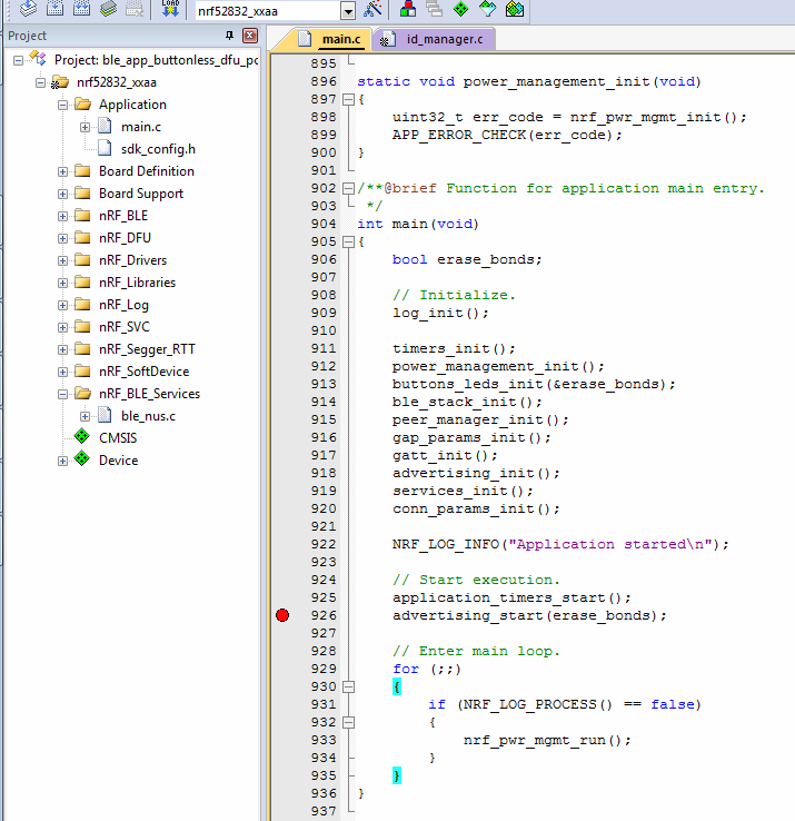

I've also tried debugging
  1. I set breakpoint image description

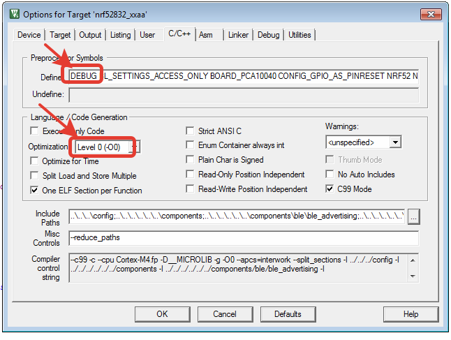

  2. Change Keil options for debugging image description
  3. Compiled, Programm project (OTA DFU)

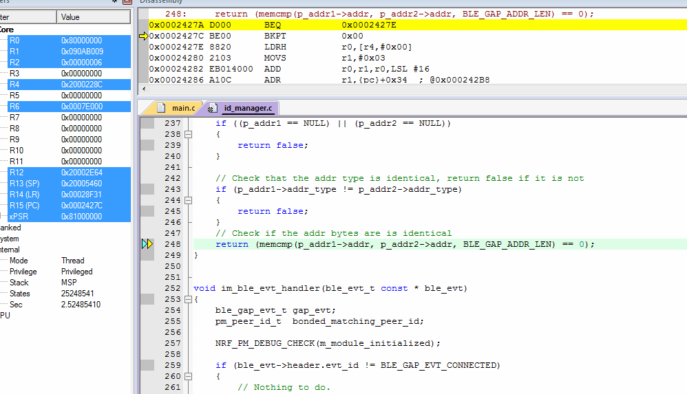

  4. Start debug session (Ctrl + F5) and get this window
image description
