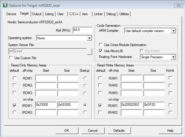

Compiled without errors. app not works, in log "fatal error".
here find that we have to increase service counter. I couldn't find it in SDK14, so I found
// <o> NRF_SDH_BLE_VS_UUID_COUNT - The number of vendor-specific UUIDs.
#ifndef NRF_SDH_BLE_VS_UUID_COUNT
#define NRF_SDH_BLE_VS_UUID_COUNT 0
changed count to 1
Now it's compliant to
nrf_sdh_ble: RAM start should be adjusted to 0x200020F0.
nrf_sdh_ble: RAM size should be adjusted to 0xDF10.
nrf_sdh_ble: sd_ble_enable() returned NRF_ERROR_NO_MEM.
I also tried to change IRAM settings for different values. But nothing changed image description
