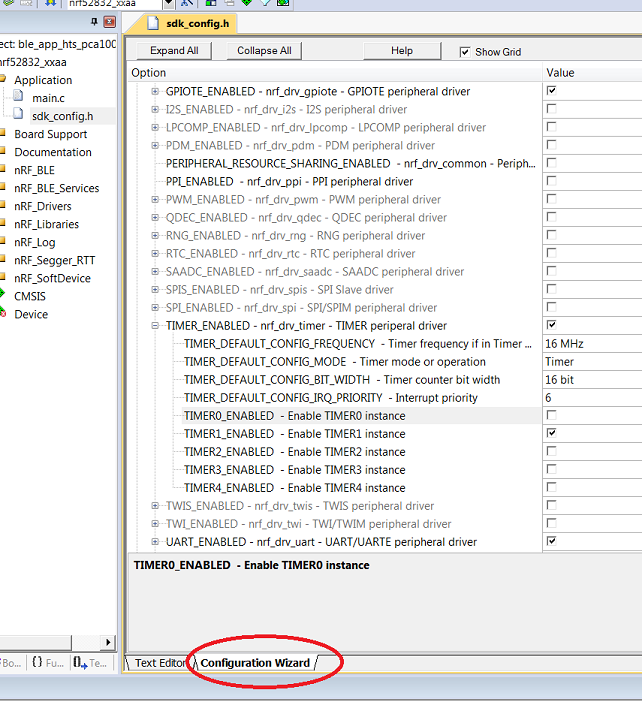

I am using SDK 12.2.0 with secure DFU service.i want to use pwm in my code.And i init pwm with APP_PWM_INSTANCE(PWM1,1),then i get an error:identifier "TIMER0_ENABLED" is undefined.
Samething i have done in SDK11 by enabled timer is SDK Folder/component/driver_nrf/config/nrf_drv_config.h file.
But i have not found any nrf_drv_coonfig.h file in SDK12.2.0.
