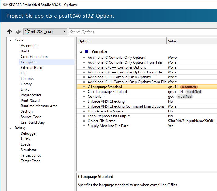

Also, I have configured the compiler further like this.
Option0
I chose GNU11.

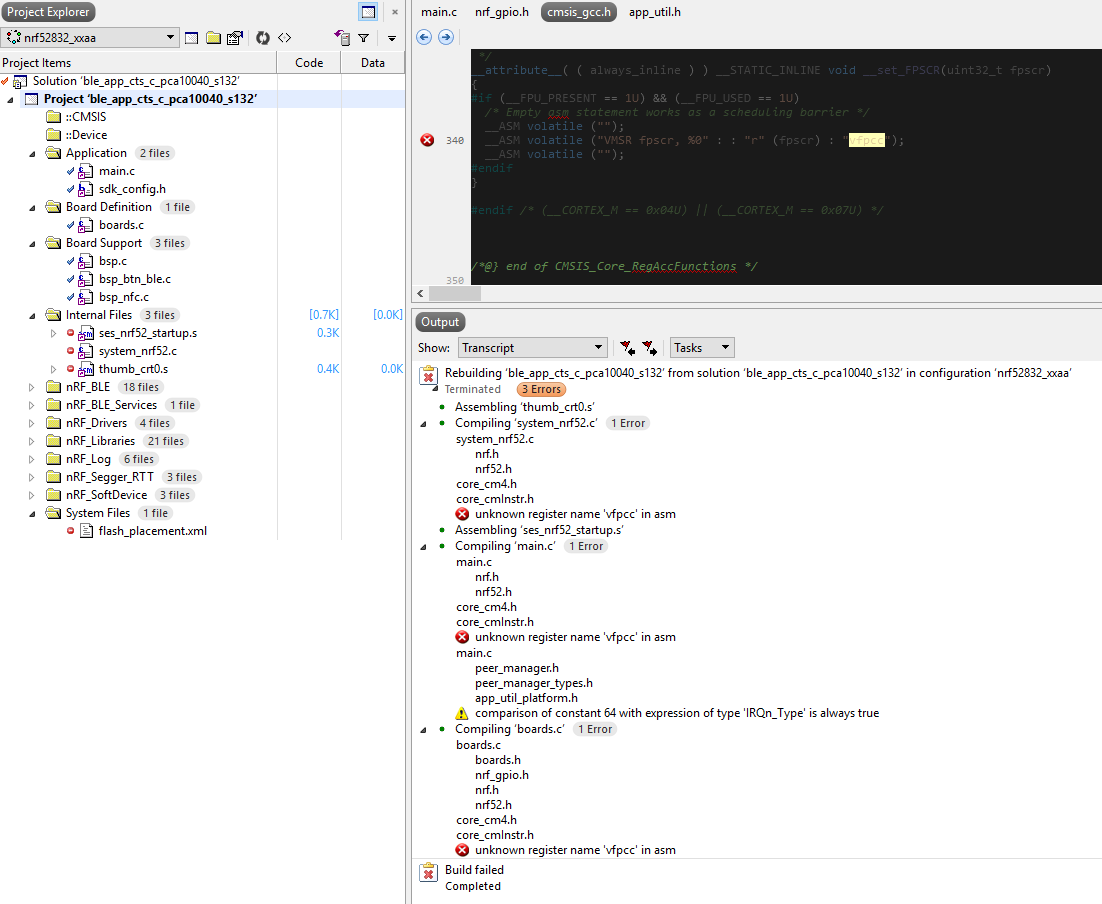

However, compared to Keil MDK 5 that it was compiled and build successfully, I observed two compiler errors.
- When configured to GCC; variably modified '_do_assert' at file scope

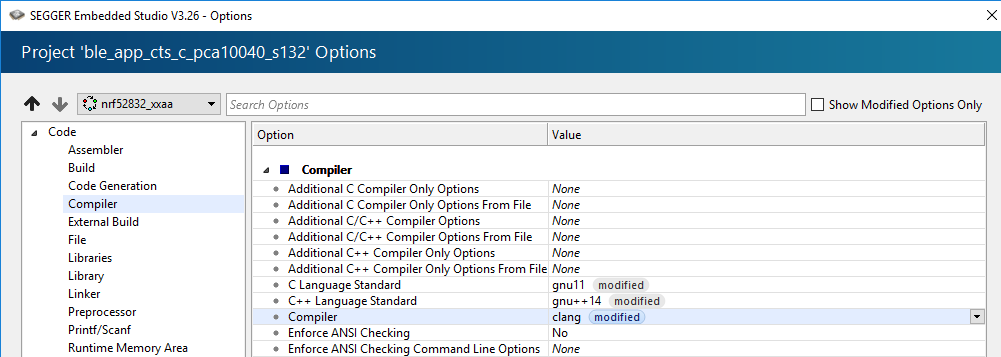

- When configured to Clang; unknown register name 'vfpcc' in asm
Clang Config
Compile Error 1
#if (__FPU_PRESENT == 1U) && (__FPU_USED == 1U) /* in cmsis_gcc.h*/
  /* Empty asm statement works as a scheduling barrier */
  __ASM volatile ("");
  __ASM volatile ("VMSR fpscr, %0" : : "r" (fpscr) : "vfpcc");

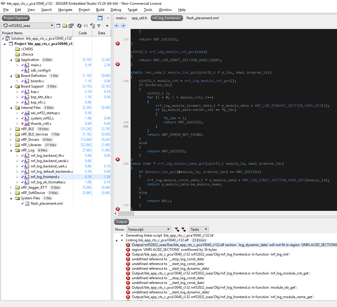

This is the content of the flash_placement.xml file.
I think I have to edit the flash_placement.xml due to the following error message;
ERR
elf section `.log_dynamic_data' will not fit in region `UNPLACED_SECTIONS'
undefined reference to __stop_log_const_data
undefined reference to __start_log_const_data
undefined reference to __start_log_dynamic_data
I think these fields should be written in the XML file. However, I don't know how and what specifications are needed.
Did you add something in the XML file, @Joakim?
Or do I need to remove a preprocessor?

    You can disregard the above. Regarding the variably modified '_do_assert' at file scope error when using GCC as compiler:
    In the file app_util.h, add this workaround at aprox. line 90:
    #if defined(__SES_ARM) && defined(__GNUC__)
    #undef offsetof
    #define offsetof(TYPE, MEMBER) __builtin_offsetof (TYPE, MEMBER)
    Your code should look something like this:
    enum
        UNIT_0_625_MS = 625,        /**< Number of microseconds in 0.625 milliseconds. */
        UNIT_1_25_MS  = 1250,       /**< Number of microseconds in 1.25 milliseconds. */
        UNIT_10_MS    = 10000       /**< Number of microseconds in 10 milliseconds. */
    #undef offsetof
    /**@brief Implementation specific macro for delayed macro expansion used in string concatenation
    * @param[in]   lhs   Left hand side in concatenation
    * @param[in]   rhs   Right hand side in concatenation
    #define STRING_CONCATENATE_IMPL(lhs, rhs) lhs ## rhs
    When following the blog-post on DevZone and applying this workaround, you should be able to make SES work with SDK 14.

    • The above error was thrown from GCC. Did you check the error from Clang and a solution for it?
    • Also, can you help me with my original question which was related to thumb_crt0.s?
    • Lastly, this was found from nRF5_SDK_14.0.0_3bcc1f7. When releasing SDK 14.1, can the dev-team provide a fix to solve the above error?
    My team is trying to migrate to SES from Keil MDK 5.
    Since Keil doesn't throw compiler errors when using the current SDK, I think we can wait until the update.
    -Best Regards
  • Hi MANGO.
    • I've been looking into your questions and it seems we are not supporting Clang out-of-the-box. My settings when using SES is; (gcc, gnu99, gnu++98)
