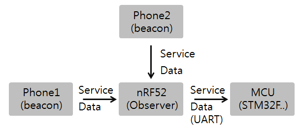

Where can I get service data?

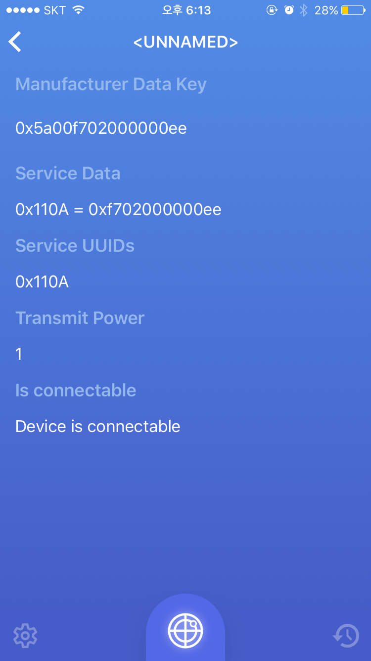

My phone is like beacon that transmit service data. (I checked service data in different phone.)
So, I want to recieve service data, service UUID with PCA10040(nRF52832) observer(central) mode.
I use SDK13.0.0 examples\ble_cnetral\ble_app_uart_c and softdevice 4.0.2.
First, I remove ble connection function in on_ble_evt()
     All except BLE_GAP_EVT_ADV_REPORT was cleared.
Second, PCA10040 transmit service data, service UUID with UART.
But, I don't konw that where store service data and service UUID.
below is on_ble_evt function for using observer mode.
please, tell me my problem.
