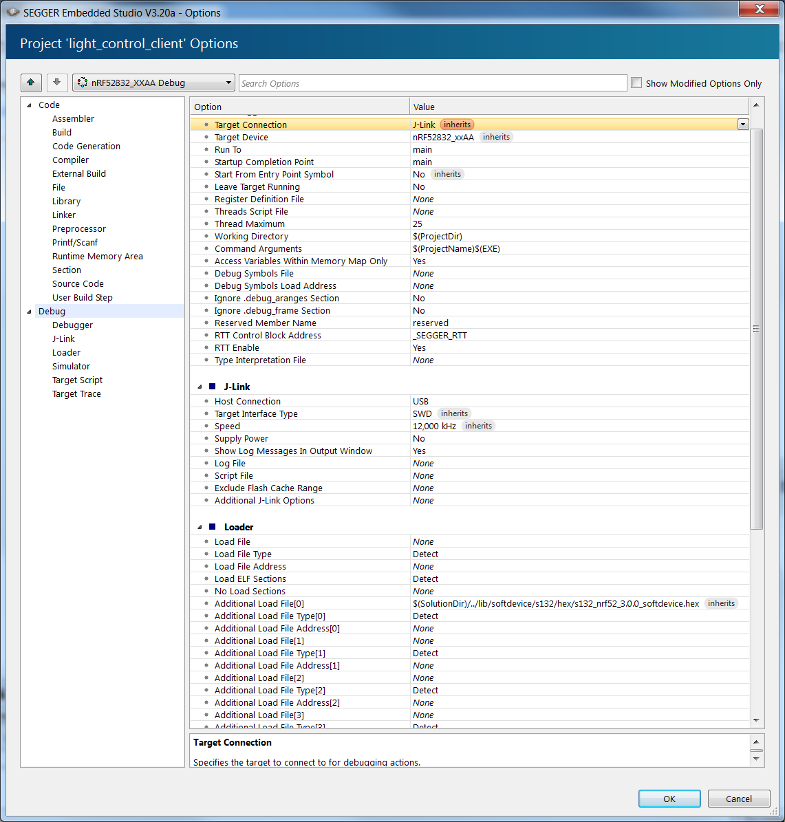

Since I use SDK14 and S132 v5, the linker is configured as
FLASH_START=0xDF20
SRAM_START=0x200020E0

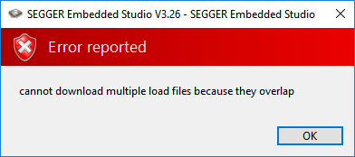

I receive this error message after building the example project;
Error Message
Take a look at my recorded video, please.
Although I have erased the flash using SES or nRFgo Studio to prevent overlapping,
this error message is shown. As a result, I cannot debug the project.
My team is trying to migrate to SES.
Until now, I used Keil MDK 5 and it had no problem running that example project. Whereas SES shows some issues.
How can I solve this overlap issue to debug the project?
