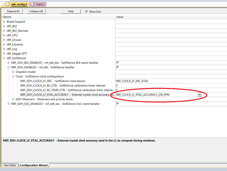

Now i try to send many data from external device. I can send it for 4 times. But after that,the device will be disconnection. I used analog discovery and I was able to confirm that the data is coming. I want to solve the problem,but I don't know what is cause.
thank you in advanced
the picture is shown in below. gyazo.com/ba22bef2273e66ca23d5105f556e0a43 gyazo.com/a4ef65861f6cbba748fdc2225ae0210d
  • thank you for your reply! I am planning to create a program to send external data to iphone by changing nus_data_handler () program!! if (p_evt-> params.rx_data.p_data [p_evt-> params.rx_data.length - 1] == '\ r') Do you send data all the time if you insert the ble_nus_string_send function in the while statement in the above if statement? regards!
  • By default, the uart_event_handle() function should already have the ble_nus_string_send() function. You dont need to add it again.
    By default the function looks like this:
    void uart_event_handle(app_uart_evt_t *p_event)
        static uint8_t index = 0;
        uint32_t       err_code;
        switch (p_event->evt_type)
            case APP_UART_DATA_READY:
                index++;
                if ((data_array[index - 1] == '\n') || (index >= (m_ble_nus_max_data_len)))
                    do
                        err_code        = ble_nus_string_send(&m_nus, data_array, &length);
                        if ((err_code != NRF_ERROR_INVALID_STATE) && (err_code != NRF_ERROR_BUSY))
                    index = 0;
            case APP_UART_FIFO_ERROR:
            default:
