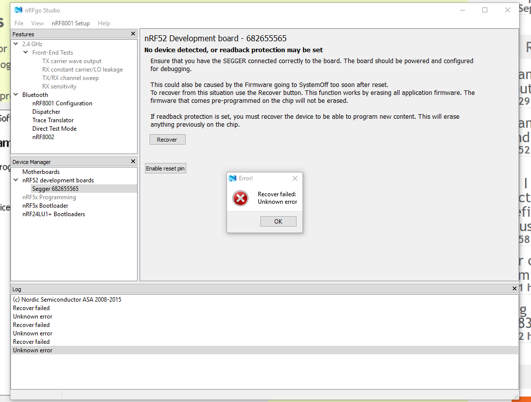

Cannot program custom board although connection is established

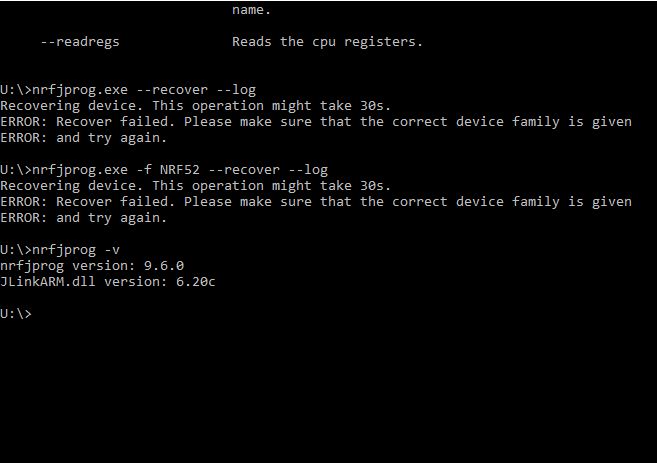

nrfjprog -f nrf52 --reset --log
nrfjprog verion 9.6.0
FUNCTION: open_dll.
FUNCTION: open_dll.
FUNCTION: enum_emu_snr.
FUNCTION: connect_to_emu_with_snr.
FUNCTION: connect_to_emu_without_snr.
Device "NRF52832_XXAA" selected.
FUNCTION: read_device_version.
Found SW-DP with ID 0x2BA01477
Scanning AP map to find all available APs
AP[1]: Stopped AP scan as end of AP map has been reached
AP[0]: AHB-AP (IDR: 0x24770011)
Iterating through AP map to find AHB-AP to use
AP[0]: Core found
AP[0]: AHB-AP ROM base: 0xE00FF000
CPUID register: 0x410FC241. Implementer code: 0x41 (ARM)
Found Cortex-M4 r0p1, Little endian.
FPUnit: 6 code (BP) slots and 2 literal slots
CoreSight components:
ROMTbl[0] @ E00FF000
ROMTbl[0][0]: E000E000, CID: B105E00D, PID: 000BB00C SCS
ROMTbl[0][1]: E0001000, CID: B105E00D, PID: 003BB002 DWT
ROMTbl[0][2]: E0002000, CID: B105E00D, PID: 002BB003 FPB
ROMTbl[0][3]: E0000000, CID: B105E00D, PID: 003BB001 ITM
ROMTbl[0][4]: E0040000, CID: B105900D, PID: 000BB9A1 TPIU
ROMTbl[0][5]: E0041000, CID: B105900D, PID: 000BB925 ETM
JLinkARM.dll ReadMemU32 returned error -1.
FUNCTION: close_dll.

nrfjprog -f NRF52 --recover --log

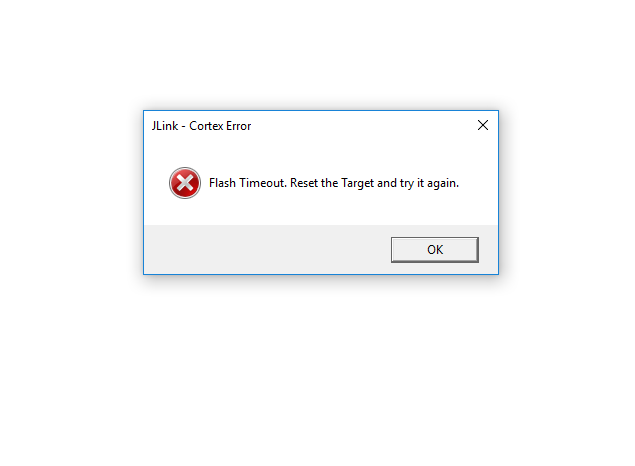

image description image description image description image description cmdErr1.PNG image description image description image description image description image description

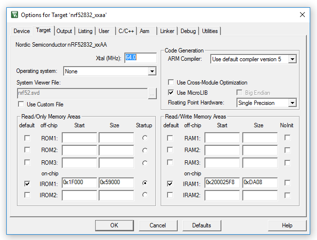

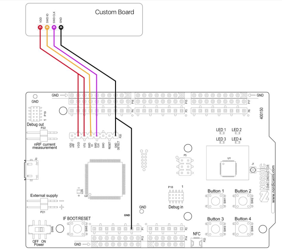

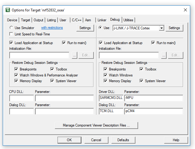

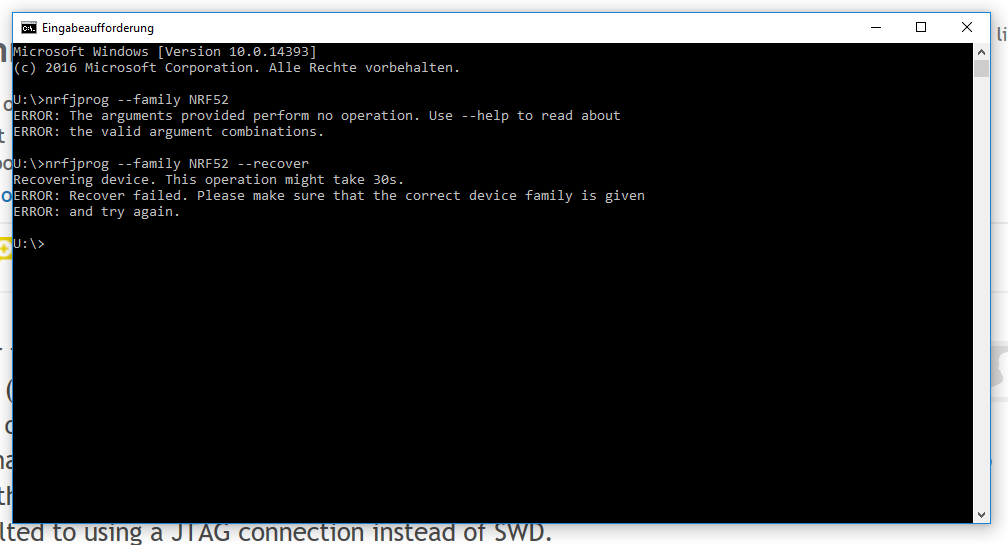

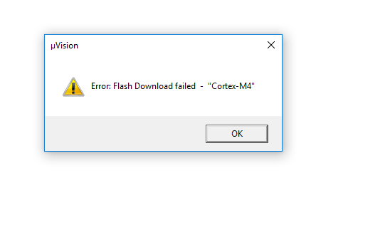

I am not able to Flash my custom board although i am able to establish Connection with my custom board using JLink commander. It always Shows an error as shown in JinkErr Image. Also Keil and Nrfgostudio dont work. NrfjProg is intalled but functions like "nrfjprog -f NRF52 --recover " Show error as unknown. Please guide what else can i Diagnose to find the failure. I have attached all screenshots whch i used while flashing the ble_app_uart Software into my Custom Board. I am using the Nrf52DK as my Programmer module and connecting Custom Board as shown in Design.jpg. Please guide as i am not able to Flash any Code into the nrf52 chip.
  • hi sorry for the late Reply. it was a Hardware issue. I was using the wrong programming Adapter on my custom board. there was another MCU which was also ´CORTEX-M4'. So i could always detect the Cortex M4 and erase it but programming using KEIL-NORDIC was not possible. all Connections were all right. The 12pf for OScillator do not make any difference even if you remove them bcos they are just for the SLEEP clock. REading all the Forums i found 90% ist Hardware Problem.some wrong Connection or soldering.
