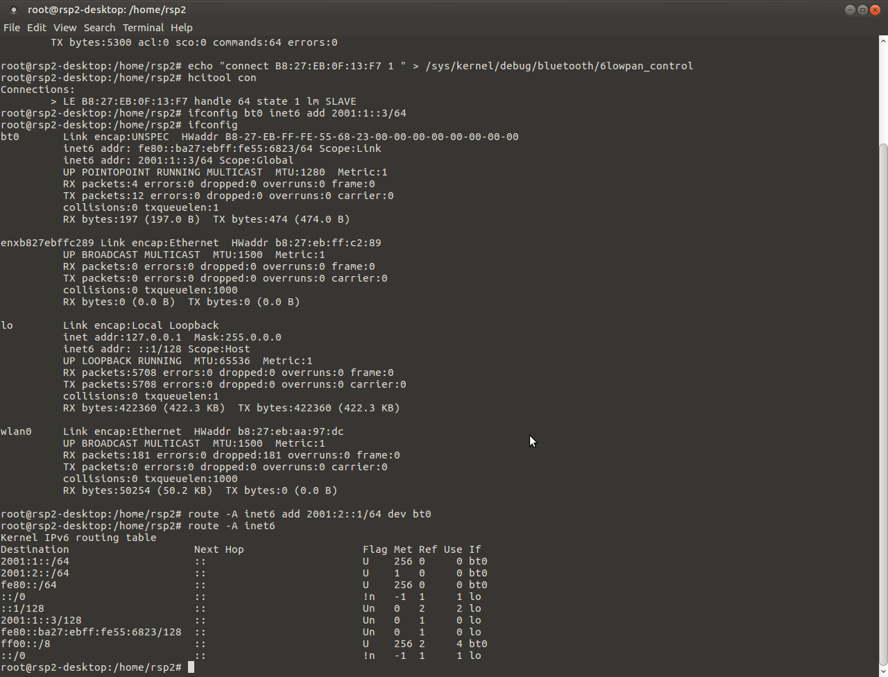

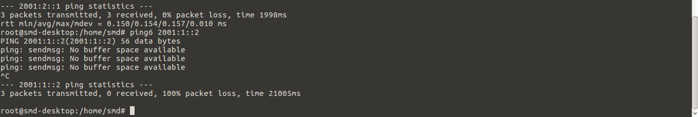

But when I added BLE3 and BLE4 to the network, None of the BLE devices couldn't ping others. All the BLE connection was established and I saw all BLE connections but they couldn't ping together. The error responds on BLE1 is = " No buffer space available" while BLE2, BLE3 and BLE4 didn't respond to ping command at all.
The interesting observation is when I disconnected BLE3 and BLE4, then suddenly ping command on BLE1 received respond from BLE2.

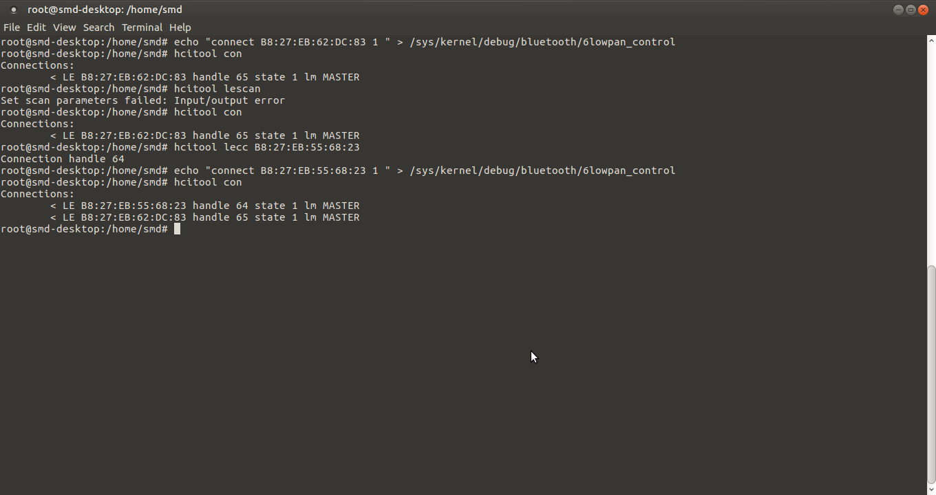

First the commands log on BLE1: (BLE1 connected to BLE2 and BLE3) image description

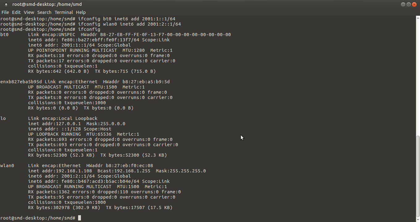

If config screen shut on BLE1: image description

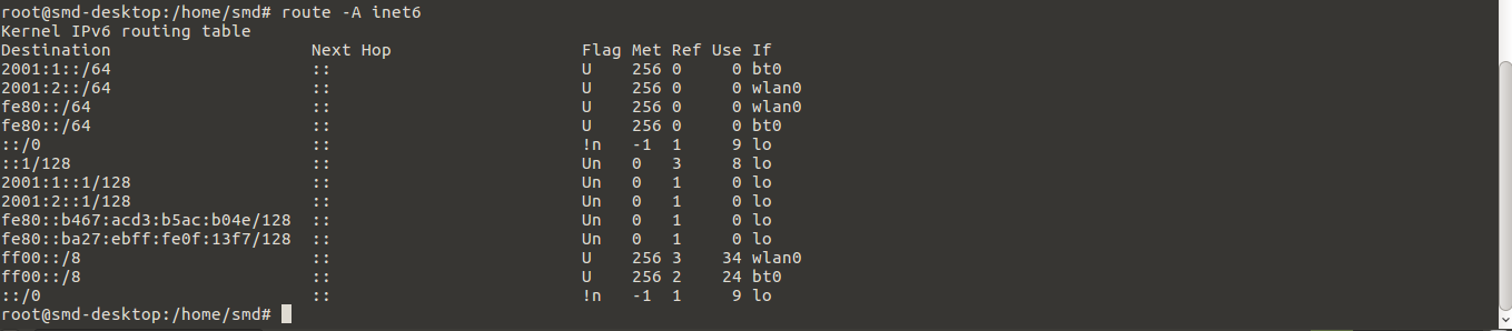

Route table on BLE1: image description
pinging BLE2 from BLE1: image description

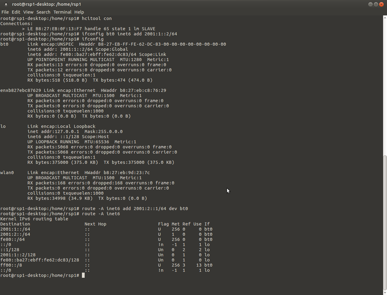

Configs on BLE2: image description
Configs on BLE3: image description
