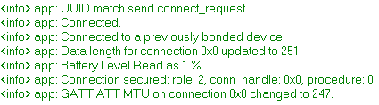

If you want to check that the ble_app_hrs_c example works, you can check the terminal output.
It should look something like this:

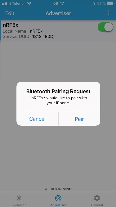

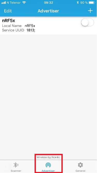

Also, the current version of the nRF Connect mobile app has a feature that lets you advertise as a peripheral that your central can connect to. In iOS, go to the middle tab called "Advertiser", click the nRF5x, and add the Heart Rate service. When you enable it, your central should try to connect to it.
When connected, your terminal output should look something like this:
Hope that helps.
