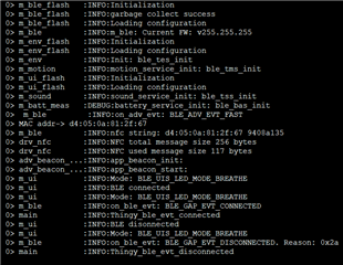

I am trying to connect the device to android phone both on nRF connect as well as normal pairing. Both seems to not work.
I get this log from the device: on_ble_evt: BLE_GAP_EVT_DISCONNECTED. Reason: 0x2a
Log from nRF connect UART: ERROR 14 (0xe): Unknown (14)
Please suggest what is the error
  • I'm having a similar problem.  I've loaded modified Thingy52 firmware, and I've downloaded the Android app for the Thingy from the GitHub.  I'm using a Samsung Tab A running Android 5.1.1.
    The Thingy will connect via the release versions of the Thingy app (through both iOS and Android app stores), but after uploading the unmodified GitHub Android code, the Thingy will connect but immediately disconnect, giving me this output on the RTT viewer from the Thingy.
    Disconnect Error
    After the disconnect, the Thingy becomes unresponsive and must be restarted.
    What might be causing this?
