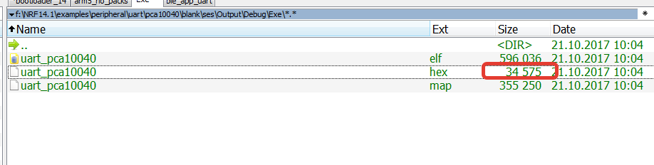

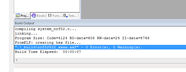

I read about Segger studio (on their website) that it reduces the code size. I try to check it out Here's my opposite result I've compiled the same app (e.g uart_example) in different IDE: keil and segger. the result for Keil:
image description

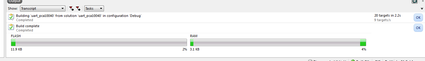

for Segger:
image description image description

  • The question is .. isn't it good for Segger studio users to have in almost three time bigger code side in compare with Keil users for the same app? I think it's very important to generate less size of hex file for MC compilers because MC's flash is very a critical resource
