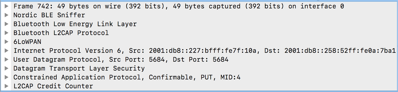

  • From the provided capture file it looks like the Sniffer is unable to follow into connection to capture the packets.
    Wireshark will show this without any configuration, except from the key files if you are using DTLS. This screenshot shows how it will look like in the packet details:
    image description
  • There is a known issue with the nRF Sniffer where it is not able to follow link into a connection, please see this answer for some suggested solutions.
