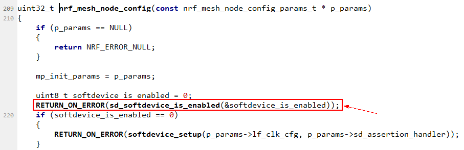

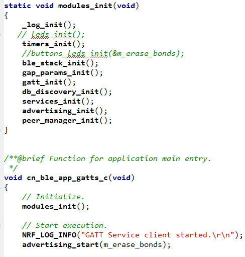

Hi I use the example "light_switch/server" project of nrf5_SDK_for_Mesh, and I want to add ble scan and connect func to the project, and make it possible be discoveried and connected by the app "nRF Connect" on phone. I have got a example "nRF5_SDK_14.0.0_3bcc1f7\examples\ble_peripheral\experimental\ble_app_gatts_c" on nRF5_SDK_14.0.0, and it can achieve the above mentioned functions,so I want to combine this two examples. I make it compile completed, and when I run the firmware, and a MESH ASSERT error occurred. First I run this image description

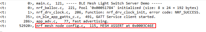

then I run this
image description
the error occured at "RETURN_ON_ERROR(sd_softdevice_is_enabled(&softdevice_is_enabled));" image description

    The error you got was most likely related to how your initialize the softdevice. You can check which function return the error by using addr2line -e your elf file 0x0003C46E
    You can have a look at the answer by Rick here. It was made for SDK v12 and older Mesh SDK, but the principle is the same.
    I would suggest before you combine anything, try to understand the code and how it work on both the mesh example and BLE example.
