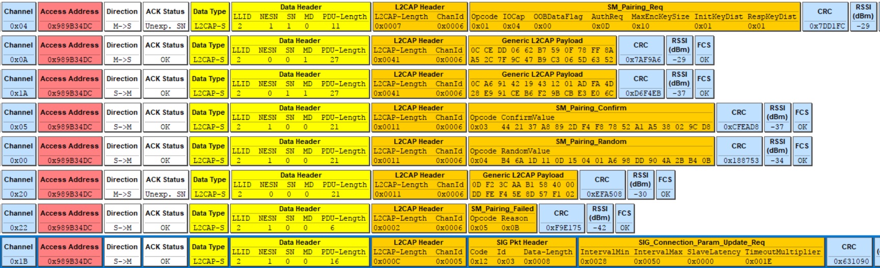

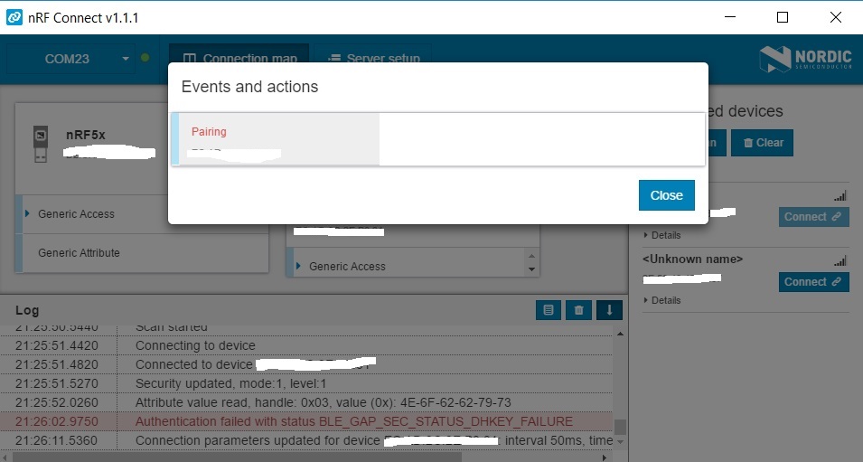

I have tried to mimic the LESC multi role example to my own app, but I dint have luck to pair it using LESC, MITM, and perform bonding and I received a SM_pairing_faill reason 0x0b; screen capture below:
nRF connect PC
image description
nRF connect PC failing to pair
image description
sniffer capture
image description
details: Peripheral running on my peripheral device nRF52 with SDK13. Central using a nRF51 using PC nRF connect firmware.

    Have you handled BLE_GAP_EVT_LESC_DHKEY_REQUEST event in your application ? Make sure you used the correct curve NRF_CRYPTO_BLE_ECDH_CURVE_INFO
    Error 0x08 mean BLE_GAP_SEC_STATUS_DHKEY_FAILURE as it shown in the log.

    it looks like my peripheral is not sending the SM_pairing_rsp. My device is sending all the message sequence chart except for the sm_pairing_rsp, what event handle it?
  • The sniffer indeed looks pretty strange. The slave didn't response to the pairing request and simply send pairing Confirm and Random. I suspect it could be the sniffer issue. Do you have the same problem with our example ble_app_multirole_lesc in the SDK ?
    If you don't could you check and compare two sniffers trace ? One from ble_app_multirole_lesc and one from your application ?

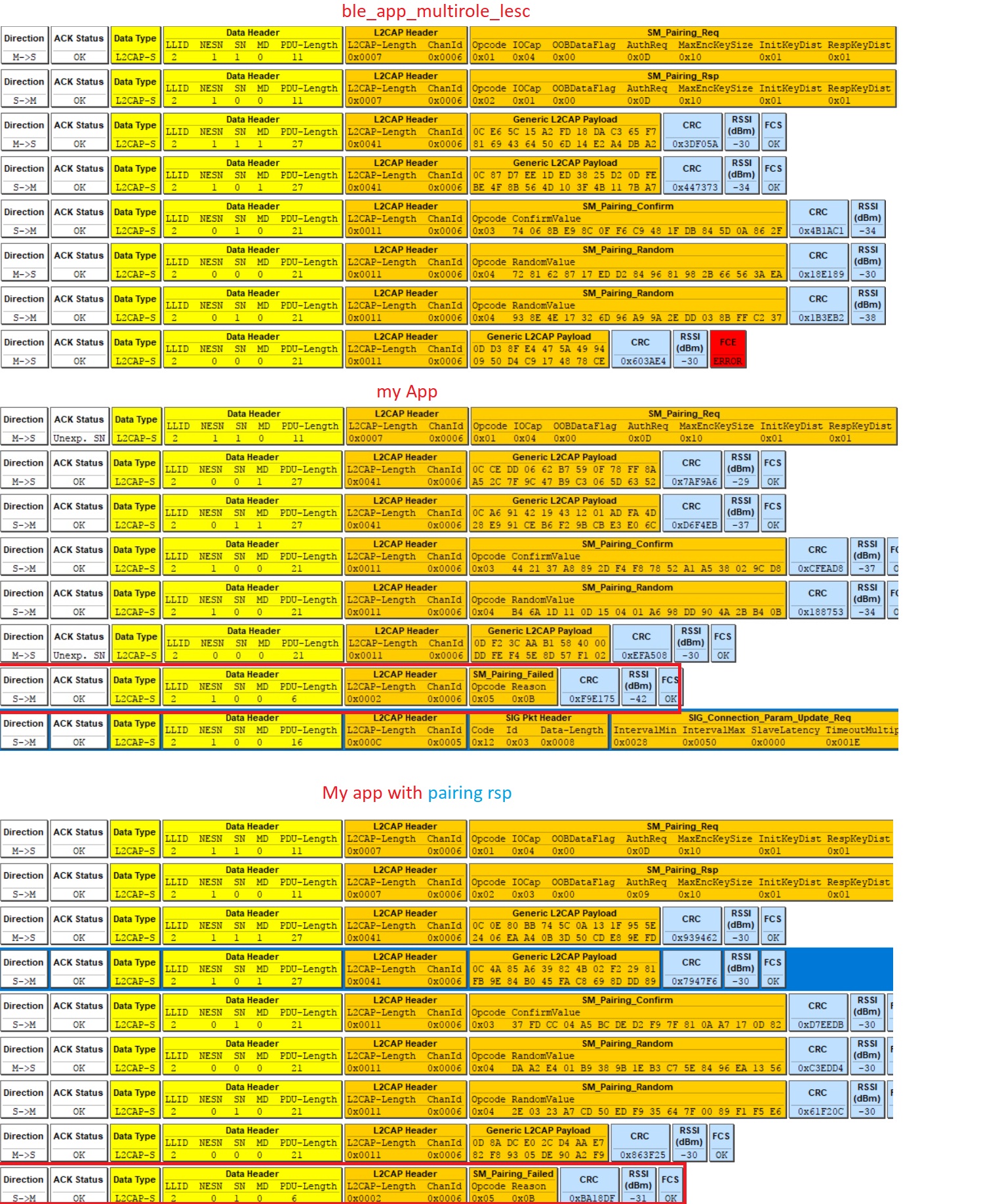

  • Hi Hung, I took a capture for the ble_app_mulirole_lesc and I am comparing it with my app it looks pretty similar the differences are on: IOcap, AuthReq and pairing is failing. image description
    The curious is I am using the same sec_parrams and it looks like is taking some different values because of the values in the sniffer capture. the ble_app_multirole_lesc works fine for me using nrf connect version PC.

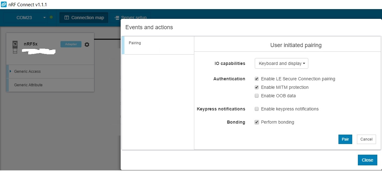

    Update:
    I tried performing on nrf connect pairing with only MITM protection and Bonding, no LESC. It is pairing and encrypting my data, but I don't know if it is actually enabling LESC (I did not select it on the pairing windows on nrf connect).

  • Hi Marco,
    What is the difference in the code in your "my App" vs "my App with pairing rsp" ? Or it's just when the sniffer can and can't capture the pairing response ?
    between 0x09 and 0x0D in AuthReq, the only difference is the MITM support. If you set MITM = 1 in your security params you should have 0x0D.
    You can check the security level when you receive BLE_GAP_EVT_AUTH_STATUS to check if LESC is used or not.
    As you can find the example worked fine, but not in yours I would suggest you to double check if there is any difference between your application and the example. I suspect it has something to do with how the DH keys is calculated.
