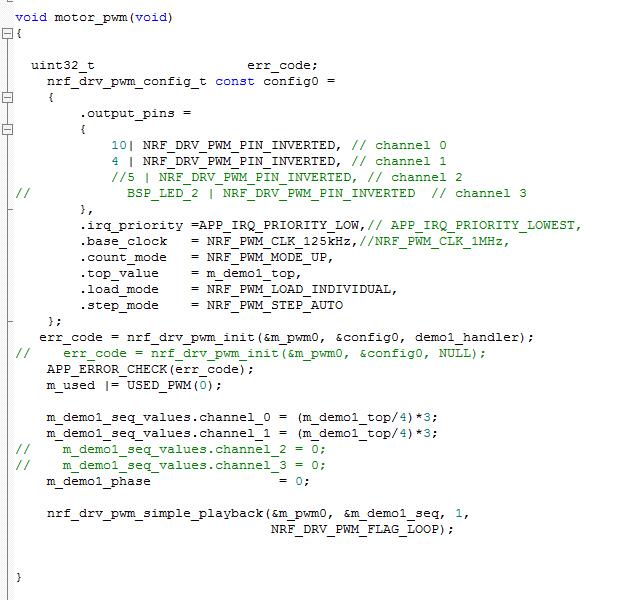

E: \ Nordic \ nRF5_SDK_12 _f012efa 2.0-3 d \ examples \ peripheral \ pwm_driver pwm_driver routines of the path, image description

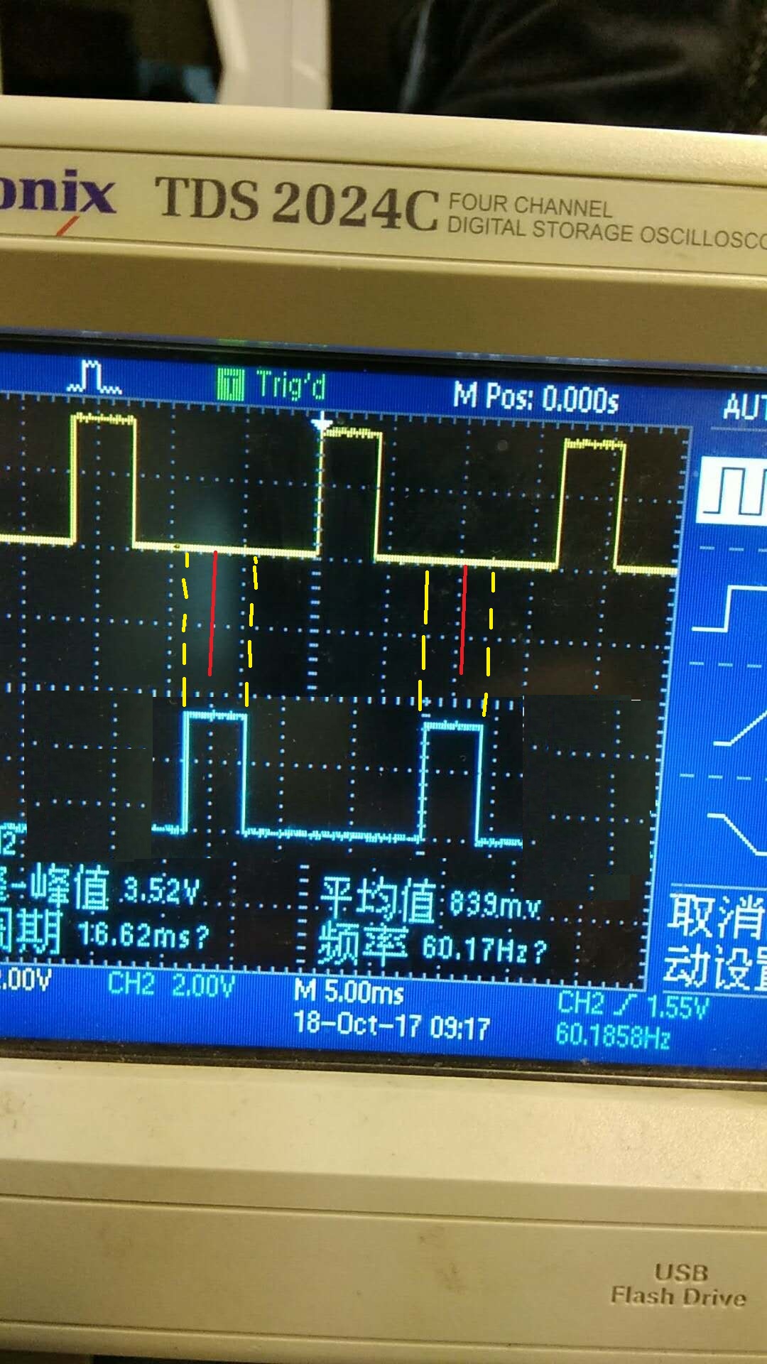

1.How to configure reverse polarity of the PWM output: when the first way is high level of the first two is a low level?
2.How to change two lines of PWM output phase: for the first two PWM high pulse in the middle of the first low PWM pulse all the way?as the chartimage description
