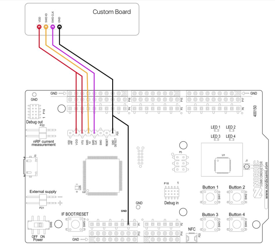

These are the connections (I've tested with external supply for the custom board also):
image description

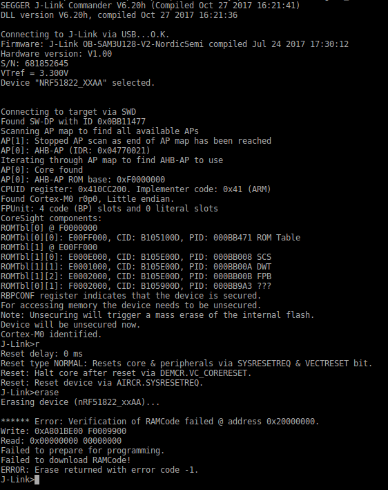

This is the output from JLinkExe:
image description
This is the output from JLinkExe if I reset the board before erasing:
image description

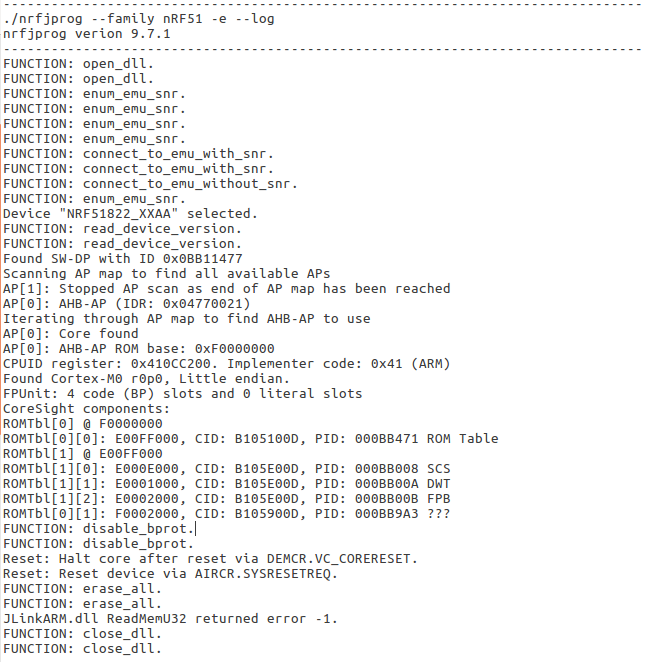

This is the output from nrfproj:
image description
Also in the custom board datasheet, it sais "Connect a 12K ohm resister to GND for flash programming".
The schematic doesn't show any resistor on P20 connector, only on P19. Could that be the problem?
Later EDIT: I tried with 12K ohm resistor, doesn't work ("cannot connect to target" is returned); I attached the log from "nrfproj --recover --log" output.
log.zip

  • Hi Bjorn. I didn't cut anything on the DK board. I managed to program the DK board without the custom board successfully. I tried to program the custom board using a 12 Ohm Resistor on the CLK line, but then, JLink could not connect to the target any more. I didn't tried to program the board using P19 connector, because I don't have the interface (connector). It may be the custom board... hope not :). Thanks
