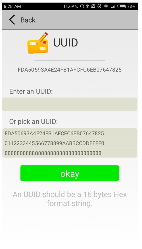

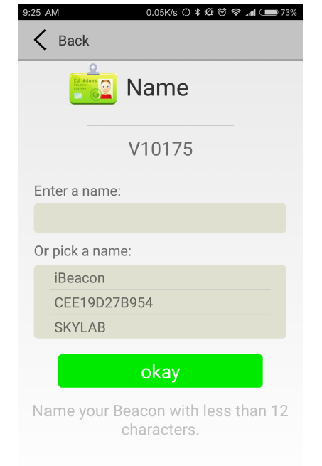

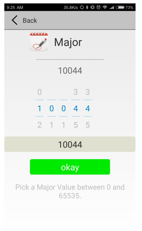

I want to develop a beacon that can modify data with smart phone App.
I'd like to modify the device name, UUID, Mojor, Minor, Tranmission Power,
Advertise Interval etc.
Like this
image description
image description
image description
I plan to use nRF Connect and utilize example(ble_app_beacon).
I'm using nRF51822 rev 2.
I don't know which example to use besides ble_app_beacon example.
What examples should I refer to?
Please help me.
