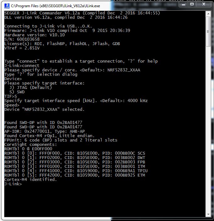

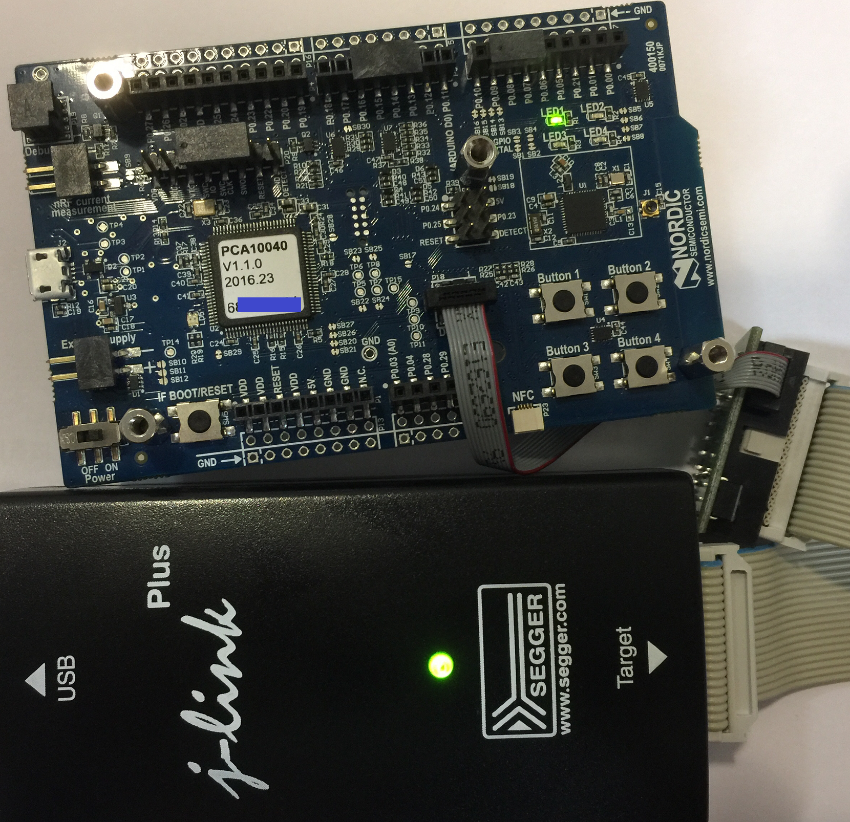

I so bought a J-Link Plus. I was testing this with PCA10040. You can check the version of the J-Link.
Dump
So I think the J-Link Plus and the J-Link software (like this J-Link commander) seems to work fine.

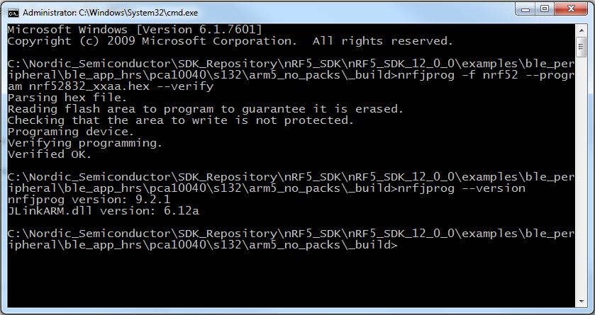

However, things don't work when using the nRFGo studio 1.21.2.10 and nrfjprog.exe.
Version
CMD

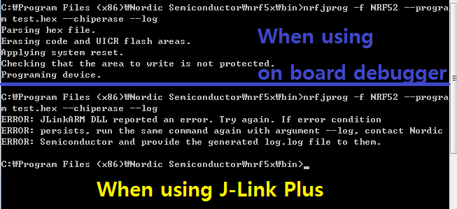

This is the log. (I tried to upload it, but the web page cannot accept it.)
Device "NRF52832_XXAA" selected.
FUNCTION: read_device_version.
Communication timed out: Requested 3 bytes, received 0 bytes !
Could not transfer JTAG data.
JLinkARM.dll CORESIGHT_WriteAPDPReg returned error -1.
JLinkARM.dll CORESIGHT_WriteAPDPReg returned error -102.
FUNCTION: close_dll.
What seems to be the problem when using J-Link Plus?

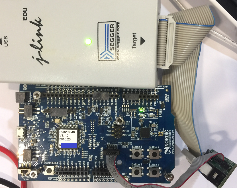

I use Keil MDK-ARM 5.21. When using BLE examples and Keil, I can download the code to flash and debug it with both J-Link Edu and J-Link Plus.
Edu
My J-Link Edu works fine with Keil, nrfjprog, and nRFGo studio.
However, the J-Link Plus cannot detect the PCA10040 and freezes when using the nRFGo studio.
The J-Link Plus can be debugged when using Keil.

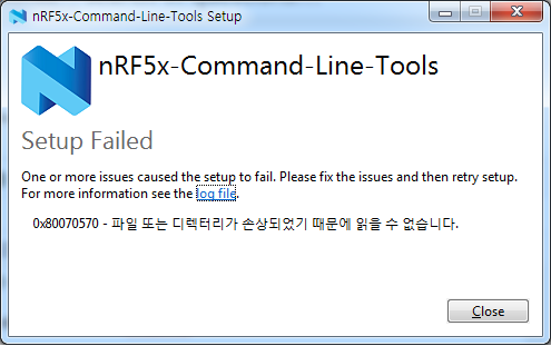

Message: File or directory is corrupted, cannot be read
nRF5x-Command-Line-Tools_LOG.txt
