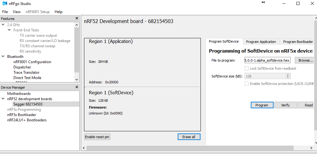

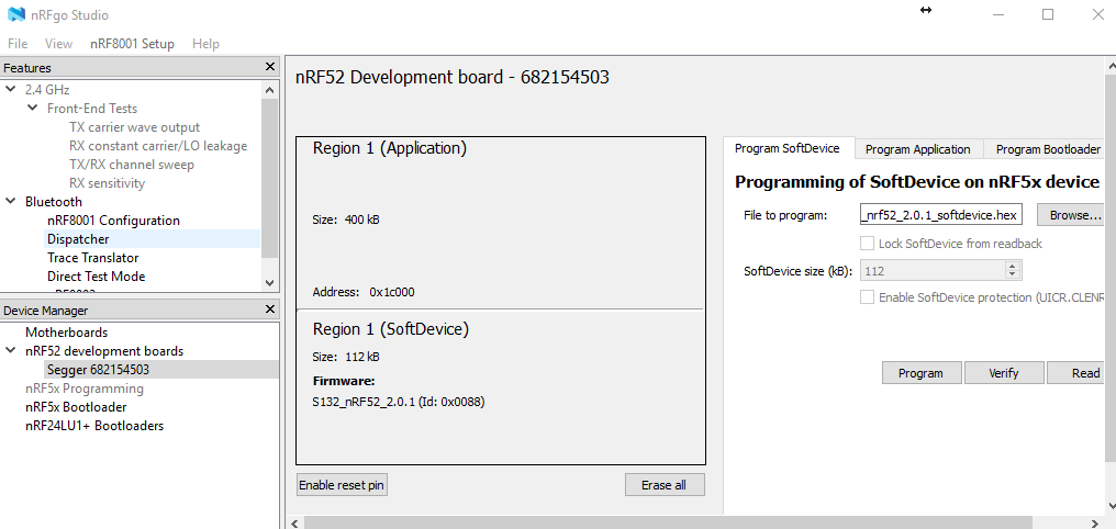

I am working with the nRF52832 pca10040 devkit, and when I program the softdevice with the nRFgo studio, the only version that shows the firmware after programming is S132_nRF52_2.0.1, while the others above it show as unknown, why is this?
i guess the id connected to the alfa release you use is not known yet by nrfgo studio.
is there a way to see what releases nRFgo Studio will recognize?
What version of nRFGo Studio is this?
That's the latest, so as Martijn says, the id is not added yet.
