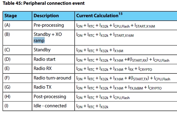

about current problems of peripheral connection event in s132
image description
dear friend,
in document S132_SDS_v0.5 page 67,there is a table as followed.i have some problems:
1,what work is done in stae (A)-(I)? can i get a detailed description?
2,which peripheral device consume the current,such as Ion,Ix32k,Ix16M?and how can i get the value of each current? best regards.
    1. I'm not sure what you mean by "work". The different peripherals that are active is listed in the table you posted. What happens in each step is internal to the SoftDevice and we can not give a detailed description about that. All I can say is that it is configuring the radio, processing TX/RX data, starting/stopping the HF crystal etc.. All according to the BLE spec.
    2. The different current values in the table are described in the respective peripheral chapter in the PS, under the electrical specification chapter.
    • I_ON is the System ON base current
    • I_RTC is the RTC clock that is required for the BLE event timing.
    • I_X32k is the 32 kHz clock that is required by the RTC
    • I_X16M (which should be X32M) is the HF clock that is required by the radio.
    • The rest is CPU and radio currents.
    You can look here, devzone.nordicsemi.com/.../, to see how different BLE parameters will impact the current consumption of the different stages in the table.
  • thank u very much. As u mentioned here infocenter.nordicsemi.com/index.jsp, Icpu,flash is called I_IDDFLASH(DCDC). How to determine it? There are some options,such as cache enabled\disabled, DCDC\LDO. How to determine which one is used? i am using nRF5_SDK_12.3.0 and nRF PCA10040, and all configurations are set by default. In addition, where can i get the sleep current of the chip (the state followed (a) to (i) in an interval)?
