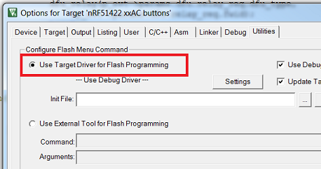

    To test this you can program the BLE_Gateway to both boards. The board that controls the LED can be programmed with nRF51422 xxAC buttons as target, and the other with nRF51422 xxAC target. The nRF51422 xxAC buttons board can then control LED-1 and LED-2 of the entire mesh network by pressing the buttons on the DK. Button 1 and Button 2 turns LED-1 off/on, and button 3 and 4 turns LED-2 off/on.
  • If you get the error --- Error: failed to execute ' ' when programming the nRF51422 xxAC buttons target, go to "Options for Target..." -> Utilities and select "Use Target Driver for Flash Programming":
    image description
