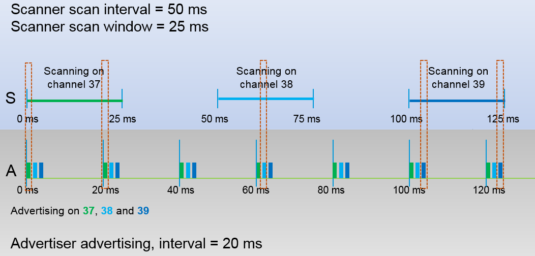

  • Thank you for the answer. It seems that #2 doesn't fit the requirements, as Central role becomes inefficient here. Regarding #1 it's still unclear to me. Increasing advertisement intervals should not be an issue, however, what are general recommendations for concurrency? Let's say 300ms is large or small interval? And I also didn't understand regarding the scanning, mainly our application requires continuous scanning, does it mean we need somehow manually stop\start scanning? Shouldn't it be possible to do transparently to SDK user?
  • With 300 ms advertising interval the central device should be able to find the device within short time. For connectable advertising, the advertising interval can be between 20 ms to 10240 ms. For non-connectable advertising (typical beacons) the advertising interval can be minimum 100 ms. E.g. Eddystone beacons use 200 ms advertising interval.
    You don’t need to manually start/stop scanning, you can keep the scanner on all the time. Regarding the “scan duty cycle”, in BLE we have scan interval and scan window, that decide how often the central scans and how long. You just tell the SoftDevice the settings you want to use, and tell it to start scanning, and everything else is transparent and done automatically for you in the SoftDevice.
