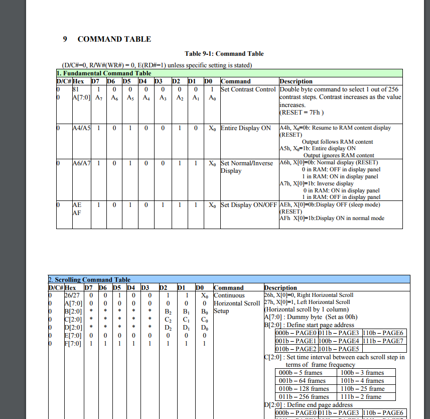

Code gets stuck in m_xfer_done loop while trying to interface with a TWI OLED display
I'm trying to interface this cheap OLED display from ebay
and while running and debugging the code I think should work(all based off the TWI_sensor sdk example just edited it to my need) the code gets stuck in the loop: while (m_xfer_done == false);
while the err_code is 0x00
here's the code using the TWI scanner the address of the device was found to be 0x3C:

and here is the table from the datasheet: image description
