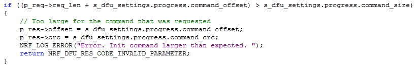

i used pca10040_debug of bootloader_secure of nRF5_SDK_14.1.0_1dda907.
i created the key by myself.
Bootloader and zip file used the same key.
My device is in DfuTarg mode.
But send the zip is not successful.
Debug : uesd break point.
See the pic.

I used the command: nrfutil.exe pkg generate --key-file %KeyFile% --application %BinFile% --application-version 0x01 --hw-version 52 --sd-req 0x90 %ZipFile%
0x90 : The number and my softdevice firmware ID is different, then lead to fail.
So i used the same id, it is successful.
thx
