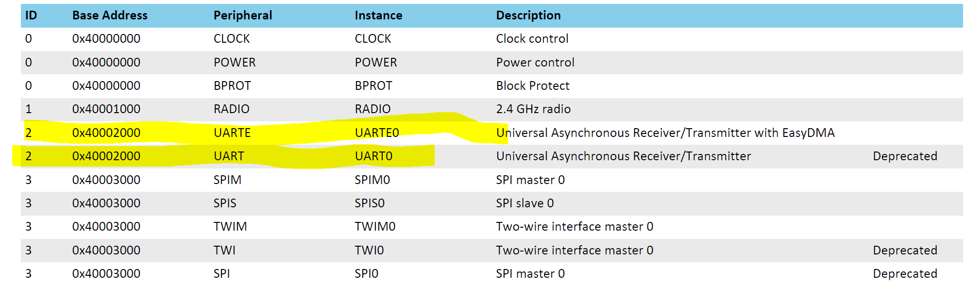

  1. Regard to the uart I’m not sure nRF5232 have how many uart instances? When I saw data sheet or reference manual it have only one uart instance that means only one module can use uart at the same time?

  • Hi Raj
    The nRF52832 only has a single UART peripheral, that is correct. The UARTE0 and UART0 modules share resources, and only one can be used at the time (the UART0 module is only kept to support legacy code, you should use the newer UARTE0 module instead).
    The GPIO system of the device allows you to dynamically reassign the UART interface to other pins, but you can only service one bus at the time. In other words this doesn't work very well if the different UART devices can send data asynchronously at any time. If the communication is always initiated by the nRF52 device, then this might work well (or if they use RTS/CTS flow control, allowing you to delay the communication until the UART is ready).
    We recently released the nRF52840 device, which has 2 UART interfaces, higher RF output power, more memory, and some other improvements, so you might consider this device also.
    Exactly why PIC controllers are popular I am not sure, but they have been out for a long time, and I am sure you can get them in many different flavors depending on your requirements (if you need many UART interfaces for instance).
    I think the current trend in the industry is to move more towards ARM Cortex based devices for low power designs, such as the ones used in the nRF52 series, and I don't see any reason why the nRF52 series should be less suited, unless the lack of UART's is an issue.
