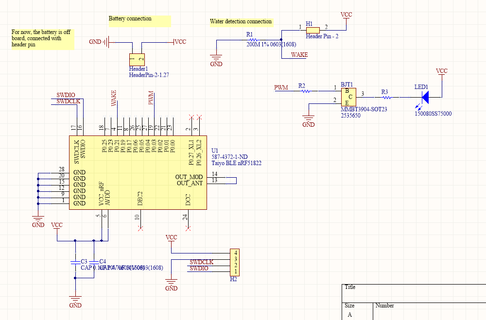

For the board I'm using, please refer to the following image: image description

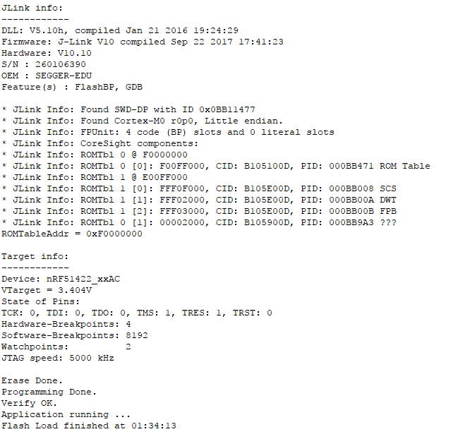

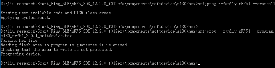

I connect the SWD interface to the Jlink and since the board doesn't have the reset and SWO, I only use the SWDIO and SWCLK to the Jlink. Then with the Jlink connected, I used command line tool to program the softdevice to this board. The command line tool shows the softdevice has been programmed. image description

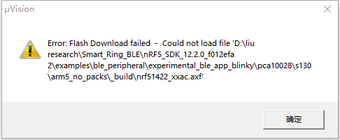

Then I open the example in Keil5, for this time using the uart example also. I build and then load to the board. image description

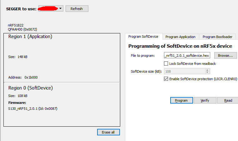

I first used the nRFGo studio to program the softdevice, same version from the previous one. image description

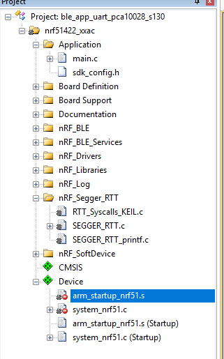

Then I tried to load the example code from Keil, but I got an error that the Flash Downloaded fail. At first, the error says Flash Downloaded fail - could no open XXX\XXX\XXX.axf file. image description ....I was so confuse by now....

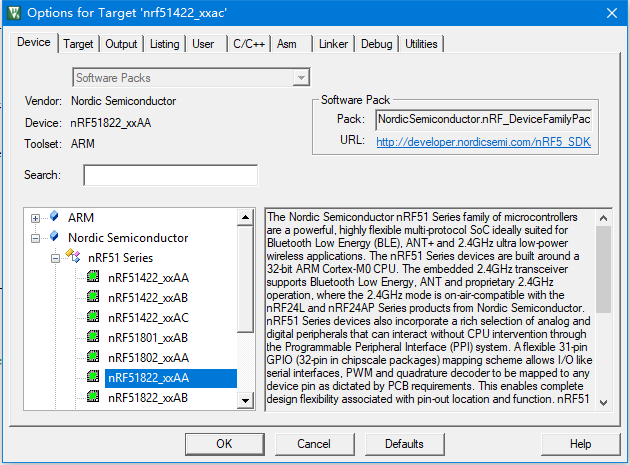

Another concern is that, if I change the device to the nrf51822_xxAA which I used with the board, the device became red and there is no update option to use for the files. image description image description

    1. If it shows red by the arm_startup then you don't have the correct software packs installed. There is a button to "manage the run-environment" in keil. Use that function to check/update the software packs. All version of the packs are on the nordic website.
    2. On nRFGo saying it couldn't load a file, then it did not establish communications with the target board. This could be because, of improper connections, wrong Vdd voltage for target, target stuck in run environment and not responding to the SWD port, or maybe just bad usb driver for segger.
    3. On the problems with the UART app not showing up on smartphone. Make sure you are using the correct version of the UART app. It should be the peripheral version. Also make sure the board is responding on the com port. Just open a terminal connection with it.

  • Actually that is not the nRFGo, the Keil says it could not load the code.

  • I wouldn't recommend starting off with having Keil load the code. Much more can go wrong for the beginner. Just compile and use nRFGo to load. Once you get it working then you can play with the debug interface for Keil.
    Also, when people work in Keil they don't realize that the SoftDevice isn't part of the build. You have to load the precompiled SD separately.
    So, I would recommend you start with a virgin copy of the UART example to fix any changes you might have made. Then fix only the section for RTC selection, compile and load from nRFGo.
    And definitely don't touch the target chip selection interface since that will clear the ROM/RAM settings. The PCA10028 project should already be set up for nRF51822.
  • Thanks for your quick reply. So, to my understanding of the nRFGo and nRF chip, I need to first load the softdevice which I like a bridge connecting the application code with the physical layer of the chip. I was trying to do that with the nRFGo, which I load the softdevice using the program softdevie option in the nRFGo studio, and the nload the hex file with the program application option to program the application code. But when I click the application, the studio says something like 'you cannot program the chip because the application take space of the softdevice, either earase the chip and program or use the program softdevice. Since I have follow the tutorial of using the DK, that's why I also use the keil for my own board programming.
  • That is why you should use nRFGo as a beginner. The error you received was because the ROM/RAM settings in your project are wrong. Only nRFGo would report this error.
    So, yes the Softdevice is the thing that knows how to talk bluetooth and acts as the bridge between application code and all things bluetooth. Both the SD and the app code need to be loaded.
    You probably messed up the ROM/RAM settings when you selected the chip variant. Either start with a clean install of the example or look up the rom/ram settings in the SD notes.
