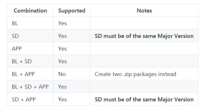

    then, I can't find an entry in list that DEVICE_NAME is "Nordic_Buttonless".
    but, instead of steps 4~5, If I do the following, Nordic_Buttonless App will work.
  6. ble_app_buttonless_dfu.hex + private.key = ble_app_buttonless_dfu.hex.zip
  7. DFU through the Android app nRF Connect.
    then, I can find a "Nordic_Buttonless".
    Q1. In above and below methods, I want to know how to do it in the above method.
    Q2.
  8. mergehex -m ble_secure_bootloader.hex ble_app_buttonless_dfu.hex -o output.hex
  9. flash output.hex
    then, I can't find a "Nordic_Buttonless".
    Why not?
