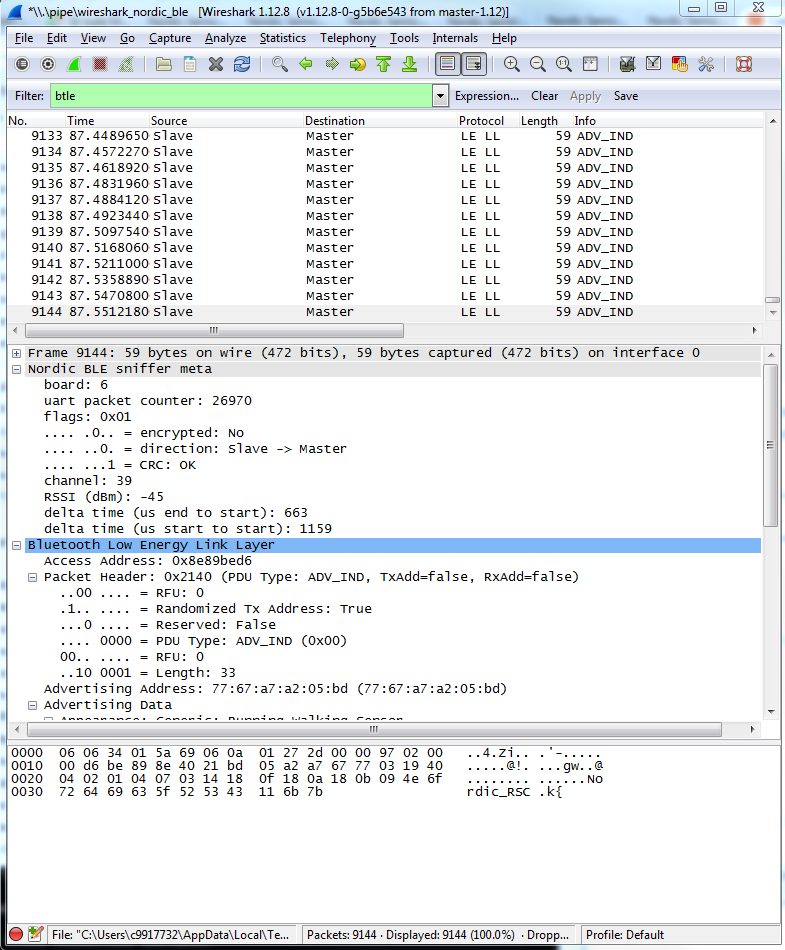

Can't establish connection from reset when peripheral and central advertise/scan with whitelist
I'm using the RSCS demo as the peripheral and the Relay demo as the central. I've modified each to use stored bond information if it is found in flash upon startup. I make sure they are connected and bonded, then I reset each board. Looking at Debug output, it appears that the central sees the advertisement from the peripheral, but the connection gets abruptly disconnected before discovery can occur. Error code 0x3E is reported. Here's a snippet of the output:

I just want to make sure using whitelist advertising and scanning at the same time is supposed to work. I'll keep looking at this and see if there's any way my application could be doing anything wrong, though.
EDIT: added attachments
relay main.c: main.c wireshark capture sniff1.pcapng wireshark screen sniff1.PNG rscs main.c main.c
modified relay project: ble_richv_demo.zip
modified rscs project: ble_app_rscs_richv.zip
  • Actually, I think they never get connected. The central sends a connection request, but the address/IRK is not in the whitelist so the peripheral ignores the connection request. The central believes it is in a connection until the peripheral doesn't respond, and then it disconnects. Something like this:
    Peripheral   -> Central      Advertising
    Central      -> Peripheral   Connection Request (filtered by peripheral, but central belives it is in a connection)
    Central      -> Peripheral   Empty Packet
    Central      -> Peripheral   Empty Packet (Disconnect)

    The second thing I would check is if the IRK distributed by the central is equal to the IRK you are actually putting into the whitelist. Maybe by printfing it.
  • @Petter, the kdist_central struct member isn't there anymore when using the peer manager as opposed to the device manager. I'm seeing the same issue as Richard. Is there something I need to do to the peer manager when using a whitelist?
