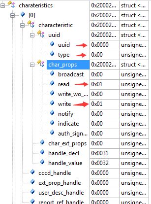

Hi team,

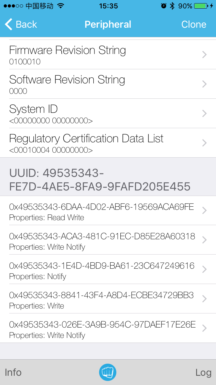

My 52832 act as central device. It can discover service and characteristic of peripheral. The problem is it can't get the UUID of every characteristic of service from peripheral when I debug with keil. But it is very weird that it can get the other attribute of characteristic, like read or notify, like the first image. I don't know what wrong thing I have did.I hope I can get some direction of checking from you.The peripheral is a heart rate device which I bought from Internet. My program is base on \ble_central\ble_app_hrs_c.
Other information: nRF5_SDK_12.3.0_d7731ad s132_nrf52_3.1.0
#define GW64_BASE_UUID   {{0x55, 0xE4, 0x05, 0xD2, 0xAF, 0x9F, 0xA9, 0x8F, 0xE5, 0x4A, 0x7D, 0xFE, 0x00, 0x00, 0x53, 0x49}} /**< Used vendor specific UUID. */
