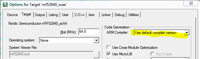

Hi everyone, I'm having troubles with a project using softdevice, and I think it could be a memory problem, I just wanted to confirm that the addresses are correct and there is no problem with that.
My softdevice version is s132 4.0.2 and I have these RAM/ROM addresses:
image description

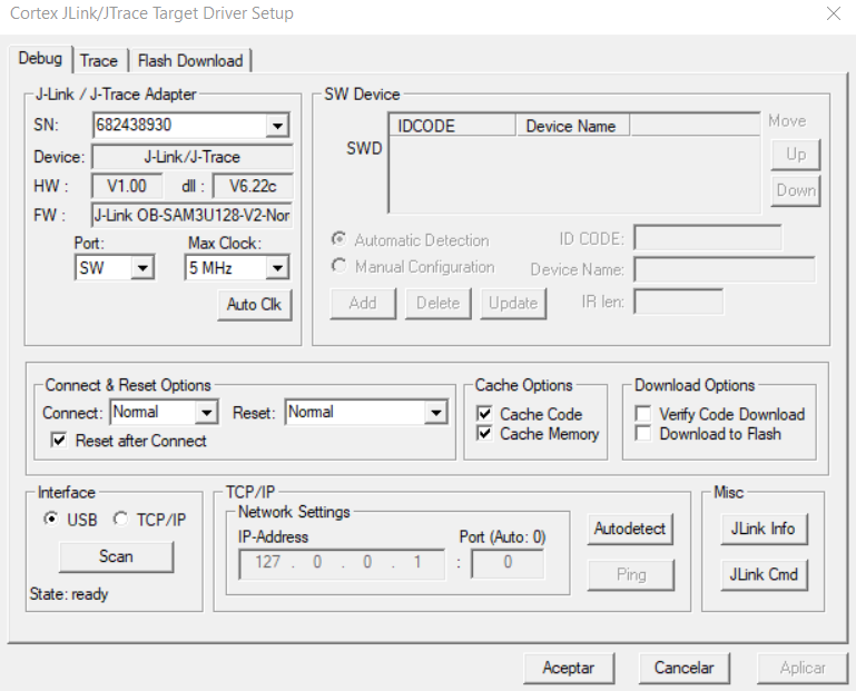

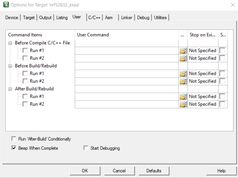

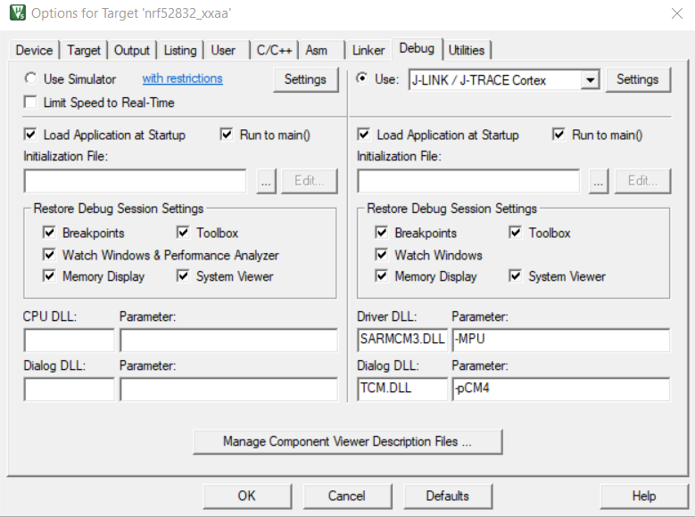

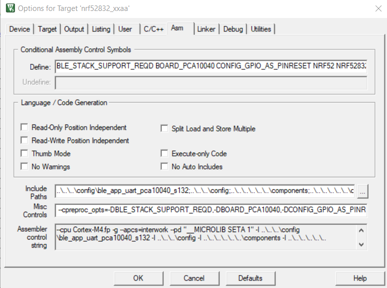

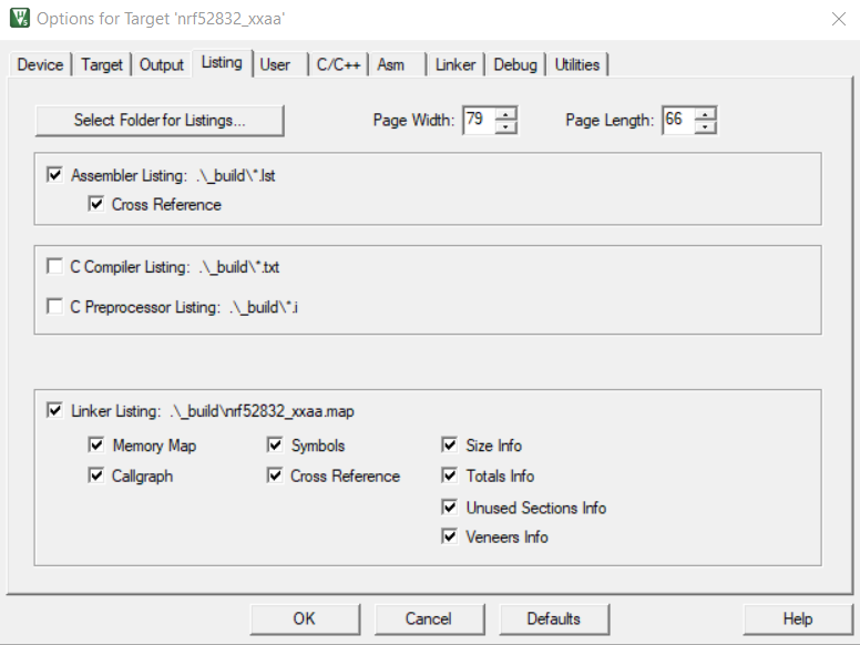

The problem is that the current consumption has increase to 4.2mA and I had 2mA, it has appeared when I changed the whole project from an old PC to a new PC, and a .hex file compiled in the old PC it works fine consuming 2mA, but when a I compile in the new PC, it consumes 4.2mA.
It could be any setting?
image description image description image description image description image description image description image description image description image description image description
Thanks in advance
EDIT: Problem solved, it was a library problem, I was using some libraries that didn't work as we wanted. Thanks.
