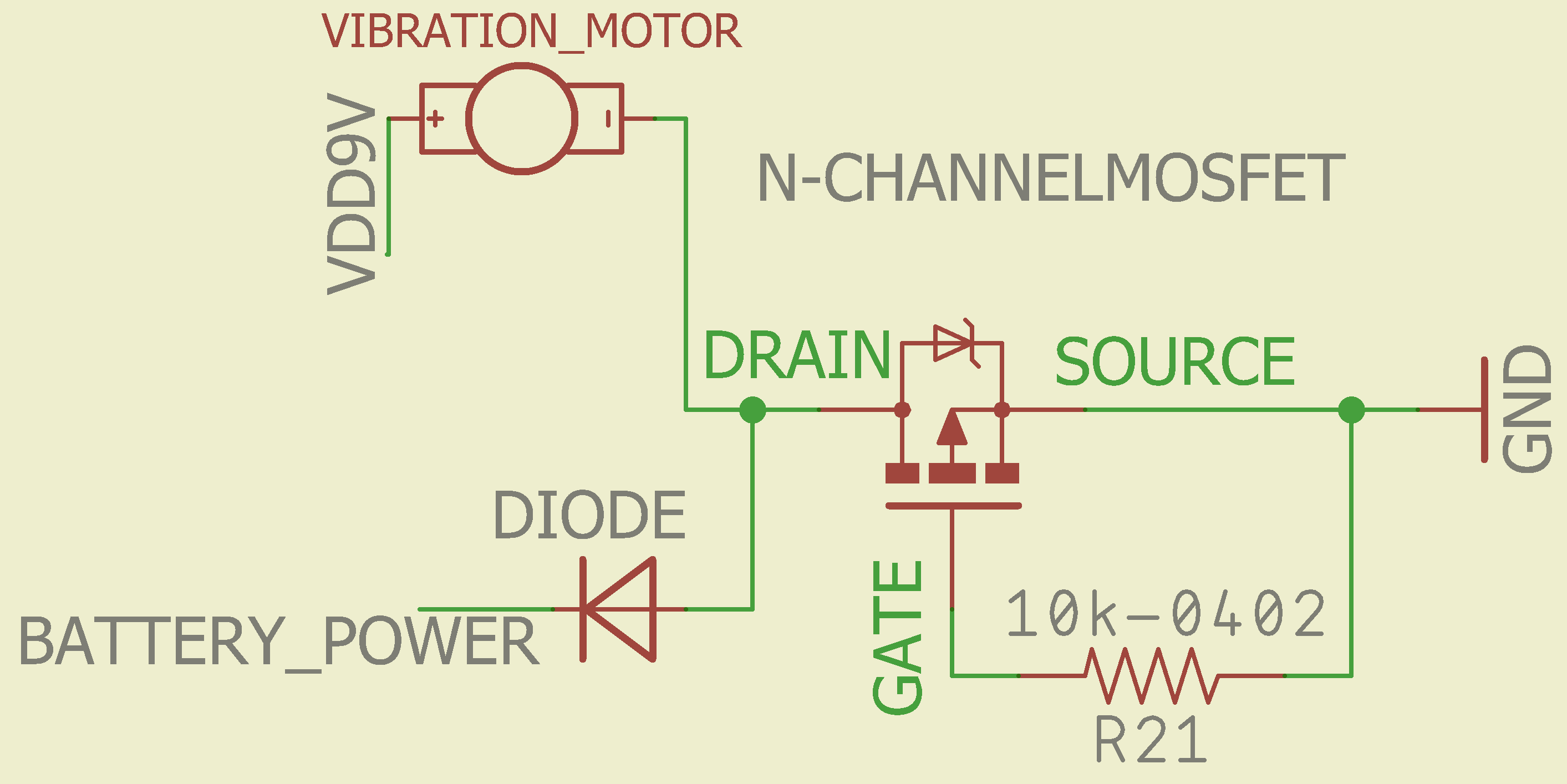

Hello, I have designed a custom board with NRF52832 IC which controls vibration motors. And I am turing on vibration motor from n-channel mosfet as shown in the image below.Gate Signal to mosfet is set by NRF52832 IC. I observed when motor is switched on for approaximately one minute, BLE is getting disconnected.
NRF52832 IC is powered from 3.3V And vibration motor is powered from 2S LiIon battery.
What might be the issue? Please help me in this regard. image description
  • Is this consistent or random? Can you check to see if the nRF52 go through a reset when this happens? What's the gate current btw?
  • I think probably RF noise is causing the problem. Most vibe motors are simple brushed motors and generate gobs of RF noise. All that local noise, a lot at 2.4GHz by the way, will eventually cause the ble stack to give up. There could easily be so much noise that the advertisements aren't getting through and most if not all of the ble channels will show as in use.
    For this reason, normally a comprehensive noise filtering circuit is used to power the vibe motor. You can't just hook it up to power and have mosfet switching it.
    Most designs employ a parallel zener to clamp the turn off spike, then a series resistance to limit the turn on surge and finally all the power and ground come through LC networks.
    In addition to radiated noise, most of that garbage is probably propagating through your switchers to Vdd_nRF causing similar issues in the analog circuits of the nRF which can be affected at lower frequencies and at RF. Finally the noise can cause momentary gpio fluctuations that can be interpreted by the nRF as pin asserts, reset indications,etc. all of which could lead to a device reset.
    The bottom line is you need to hook up the vibe motor correctly and get rid of the noise.
  • Can you emphasize on powering through LC networks? Should I keep 2.4 GHz filter between vibe motor and power lines? I am already using strong decoupling capacitprs across power supply.
  • As I said the noise could be radiated and/or conducted. Radiated (ie, off of power lines running between motor and LiPo) would likely be a 2.4GHz problem, conducted through power, gnd and switchers could be anything from mid megahertz (affecting the low IF in nRF, causing NVIC chaos through false pin asserts) through to 2.4GHz.
    You should be able to easily come up with an LC solution that covers that range. Just make sure it covers both legs of the power connection.
    This is a nice, though dated, article on the subject: www.precisionmicrodrives.com/.../ab-008-vibration-motor-best-practices-from-mobile-cell-phones
  • A comprehensive LC plan will solve all of it. But don't forget the zener and series resistance. The turn off spike from the motor could fry the LiPo and FET over time and turn on surge from lack of a series resistance could fry your vibe motor quickly.
    You can use a spectrum analyzer and an o-scope to figure out precisely what noise is the worst to guide your LC filter design.
    If you wanted to really engineer the turn on/off side of things, put an RC network on the FET gate and treat the nRF control signal as a PWM. Then you can have a soft turn on/off which will eliminate the surge and spike.
