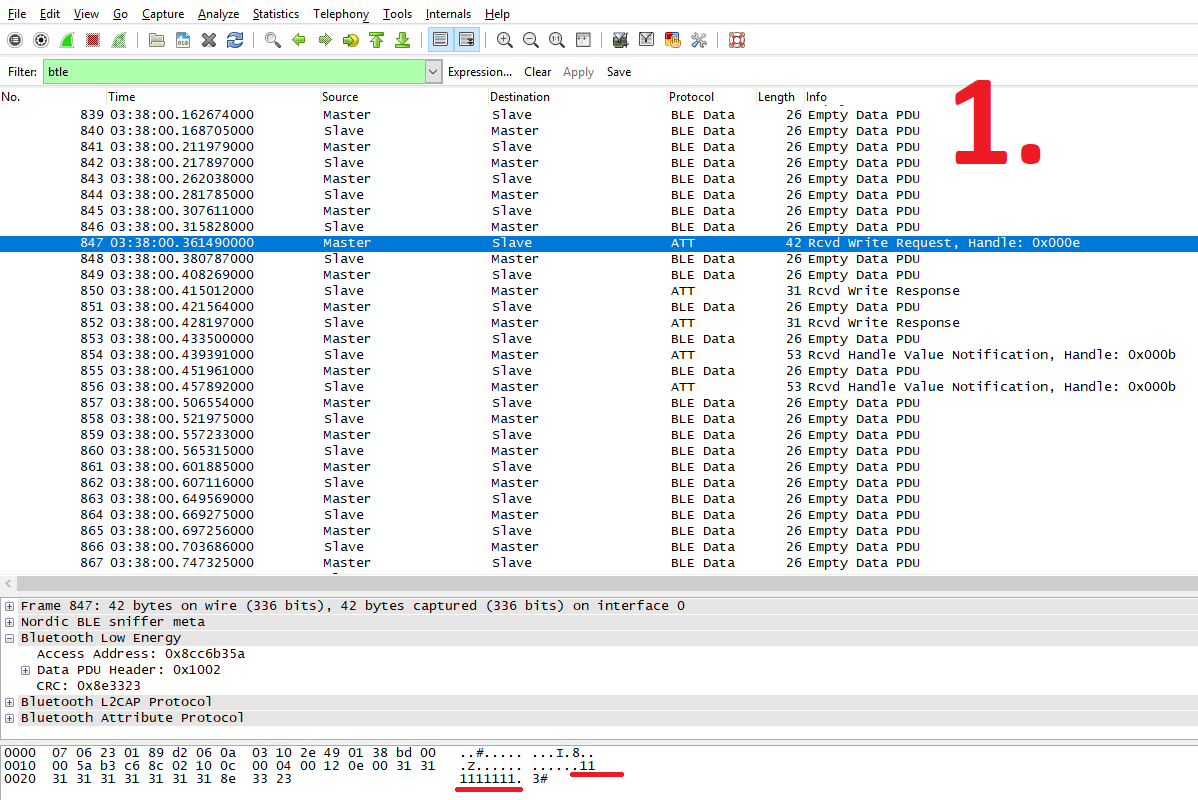

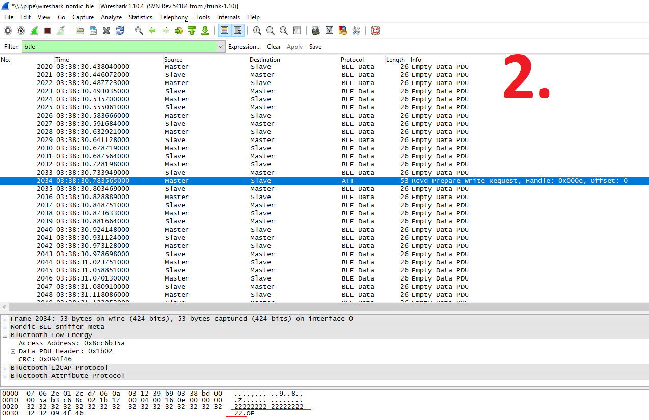

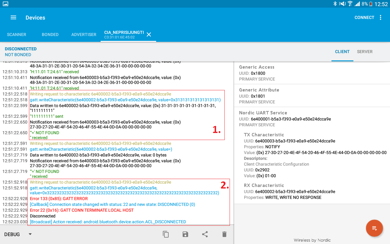

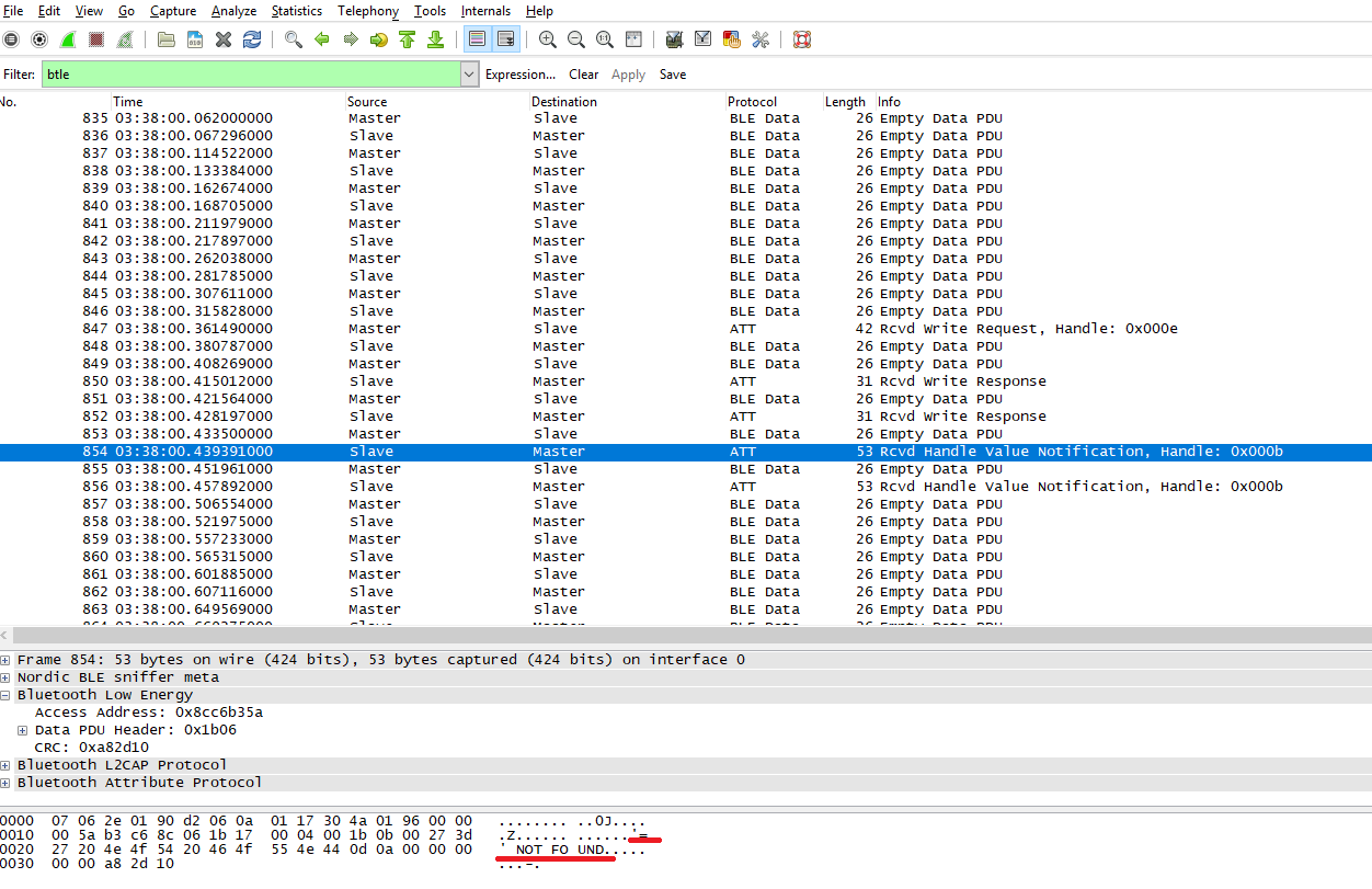

This is how i proceed the test: I've connected app to my board. Then I allowed notifications from app side. |1| Sent <20bytes (111111) packet. It was succesful. Received a reply from the board.|2| Sent >20bytes (22222222222...) packet. Have not received a reply from board, in the application logg I do not see that the packet would be sent out. Master disconnected from peripheral
Application logg:
image description!

  • Your request is split into [multiple] "Prepare Write Requsets", these needs to be followed by an "Execute Write Request", but from your log it does not seem like this happens. There might be a bug in nRF Connect if it never sends this Execute Write Request after sending the Prepare Write Request.
    who is not able to handle this >20bytes packet? Is it the app or the peripheral (pca10028)?
    No >20 byte package is sent. It is split into [multiple] Prepare Write requests.
    Am I able to detect this kind of error with peripheral and to reply back to the application that it was sent a too large packet?
    No valid BLE implementation will never send a packet which is too long according to spec.
