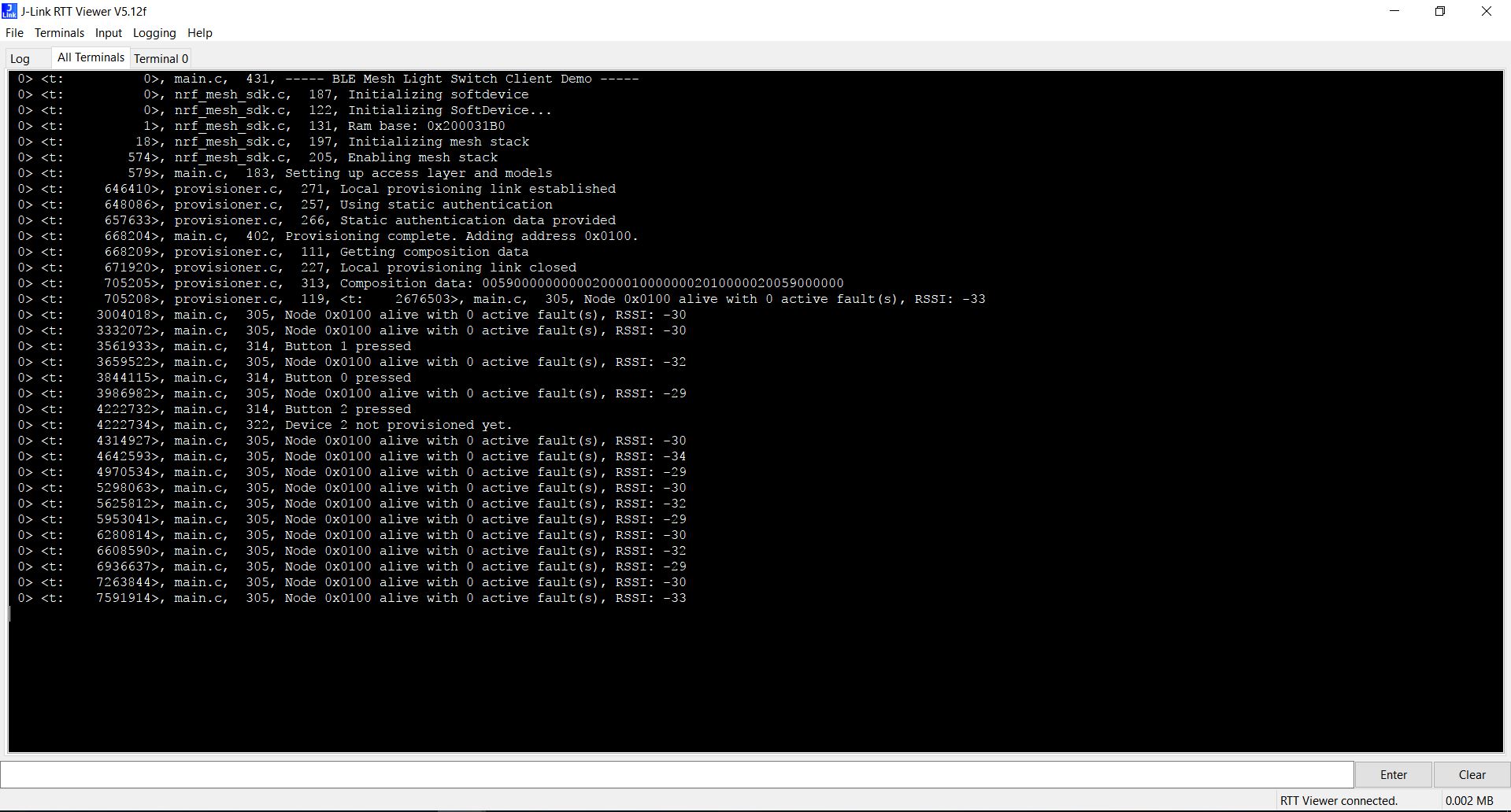

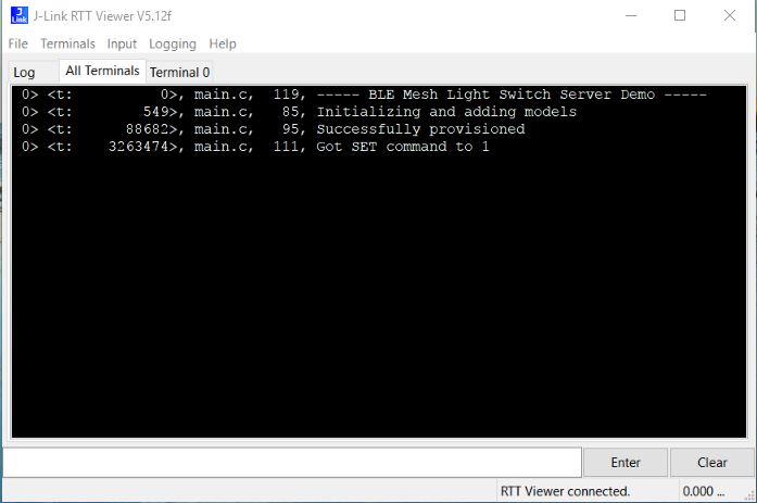

Using 3 nRF52832 based Murata module (link) and flashing the application using Embedded Studio.
As in attached images, only 1-server gets provisioned while other gives Softdevice error.

  • Hi! Hung Bui, I have attached the RTTViewer Screenshot of both the servers and the client. As soon as this softdevice assertion is made, the node goes to sleep as mentioned in nrf_mesh_node_config.c but I still don't understand why this is happening and why to just one of the nodes. Please help.
