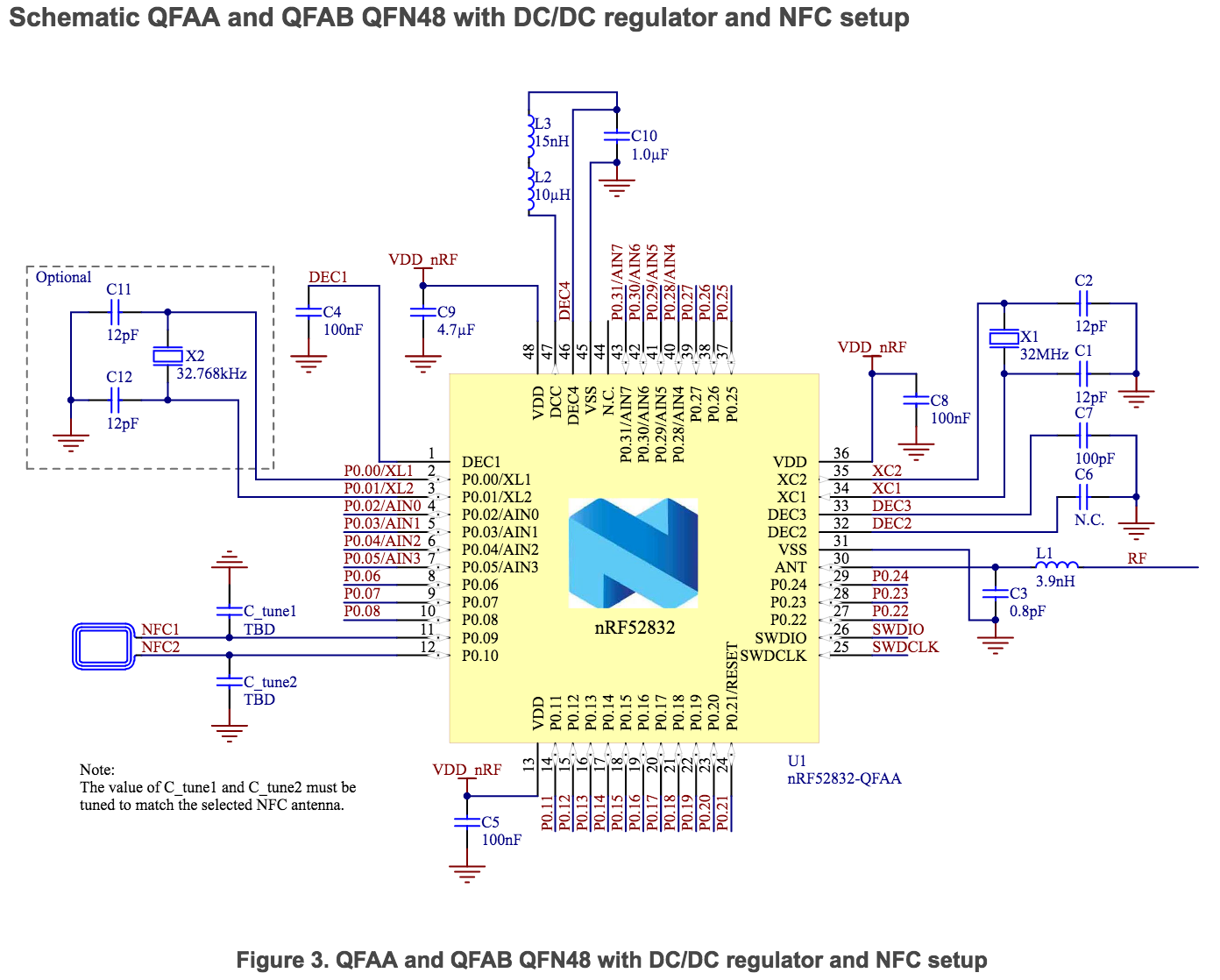

I noticed you have added C13 and C14 (12pF) caps. However, they are not visible on Infocenter's reference circuitry. What are these caps for and why they should be used?
image description
image description
Another question:
Earlier you removed DEC2 cap (C6) from reference design. After this, we haven't populated it either. Is this documented somewhere and why it's not needed any more?
