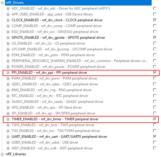

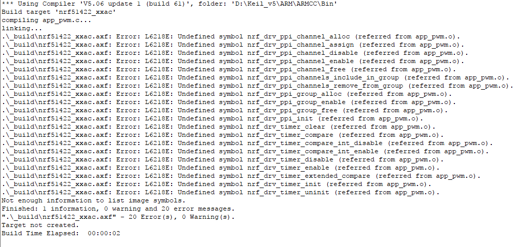

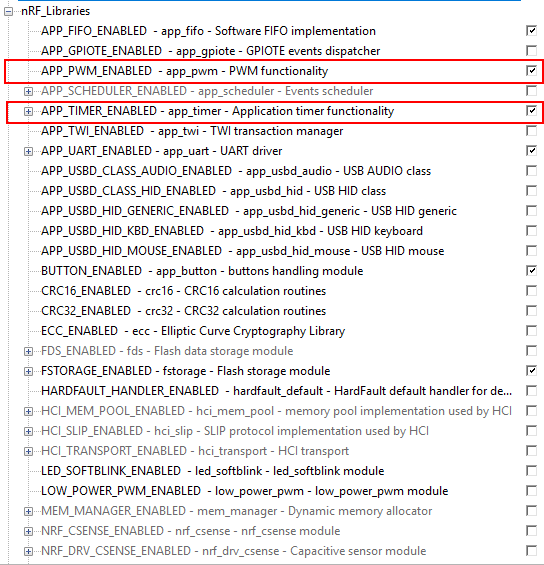

My question is, when I was trying to add the functions to my BLE uart code, the error came out. The error appears after I add the app_pwm.c file to the project. What I have done is the following:
Include the app_pwm.h header to the uart main file, Add existing app_pwm.c file to the project, Add link in the C/C++ to the project, Enable the ppi, app_timer, app_pwm in the sdk_config.h file.
After that, I build the code but the error came out like the following: image description
I have search through here and there are some people have similar issue, I have tied with their solution, but still the error came out.

image description image description
