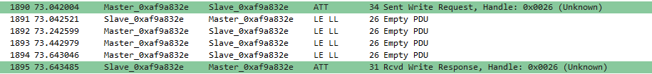

Test Setup: BLE Peripheral Device connected to Android or iOS device with nRF Connect. Once connect I perform a Write Request and monitor SWD Console Output of STM32 along with SPI and Wireshark Sniffed BLE.

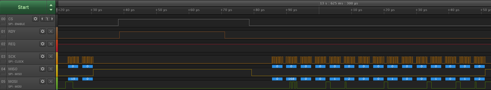

Data: Wireshark screenshot shows 600mS delay in Write Request and Response: image description

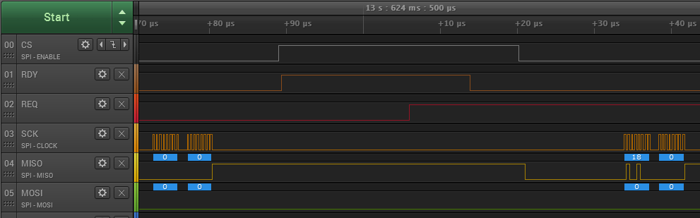

SPI Transactions:

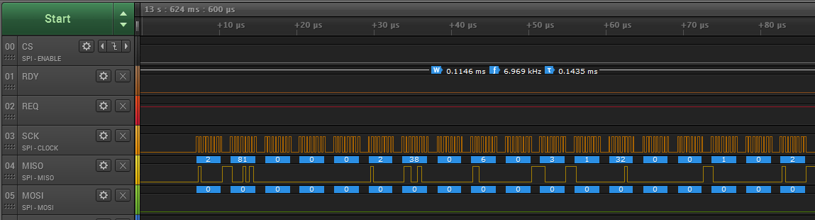

STM32 Receives BLE_GATTS_EVT_RW_AUTHORIZE_REQUEST from nRF chip: image description image description

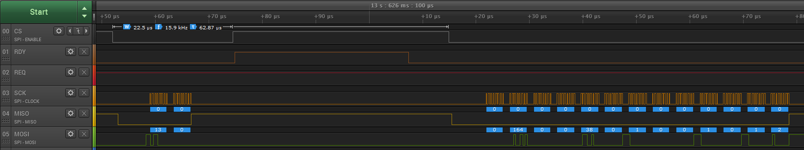

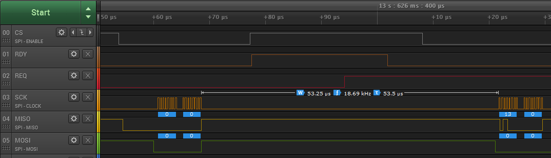

STM32 Responds by Sending SD_BLE_GATTS_RW_AUTHORIZE_REPLY: image description

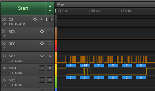

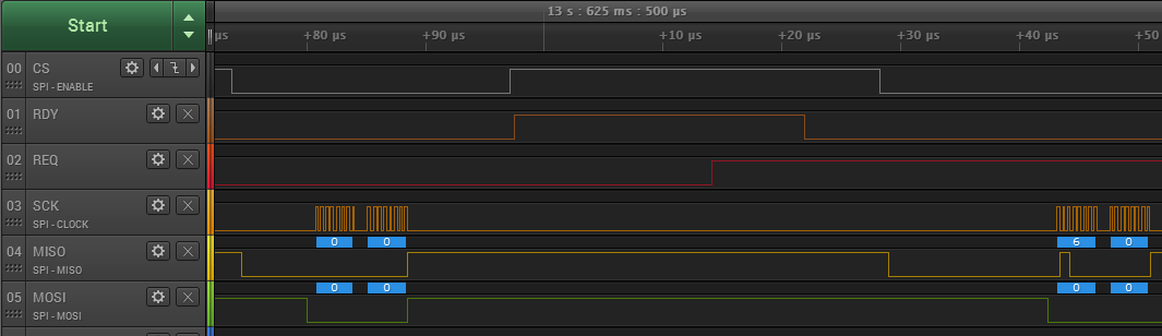

STM32 Receives response to SD_BLE_GATTS_RW_AUTHORIZE_REPLY: image description image description
STM32 Sends SD_BLE_GATTS_VALUE_SET: image description

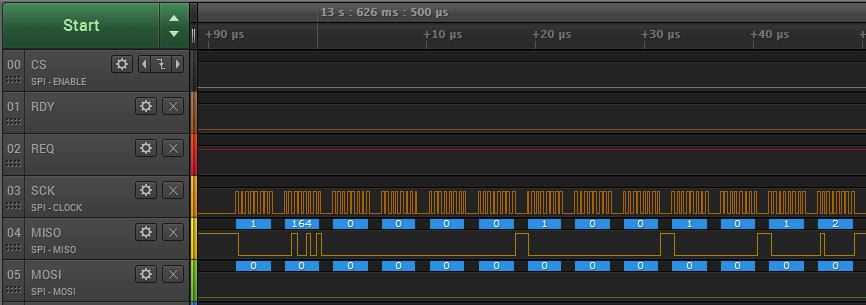

STM32 Receives response to SD_BLE_GATTS_VALUE_SET: image description image description
