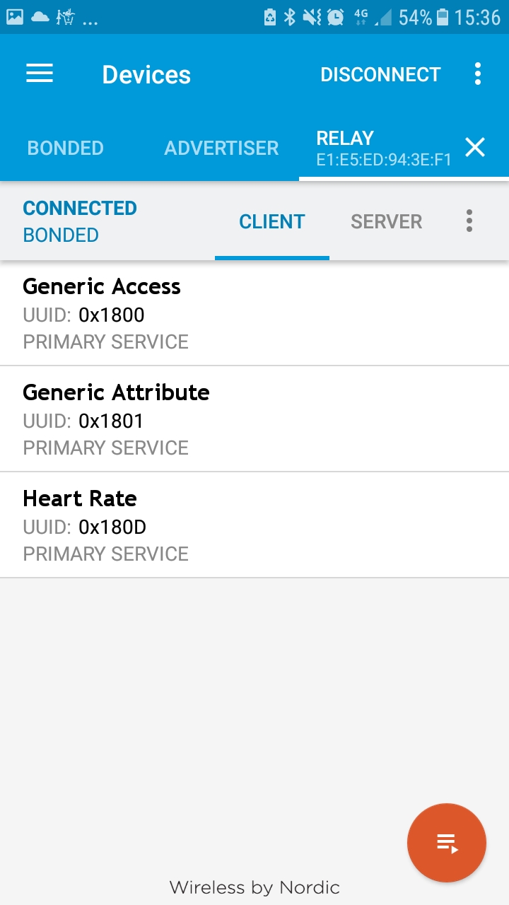

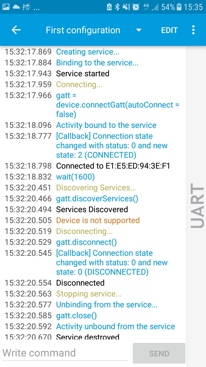

As a result, it compiles and run normally except that I cannot connect the NUS server with the smartphone application. I got "The device does not have the required service". Screenshot_20180109-153605.jpg
and on nRFConnect application, I only see the Heart Rart Service. Screenshot_20180109-153644.jpg What shall I do to correctly add NUS service?
