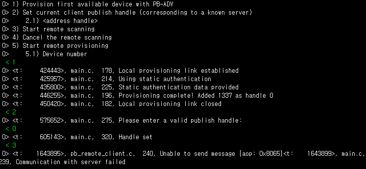

I have a Client and two Server, so i did flash the example code.
But, from the command '3', i get an error that i do not know.
Can you help me ?
What is correct value?

Hi Leejh,
Could you tell which firmwares you flashed on the boards ? Make sure you flashed pb remote server on the server board (board that you provision at step 1)
Which SDK version are you using ?
I also have the same issue. I have flashed the pb remote server on server board and i'm using the sdk version of 1.0.1.
Hi Pooja,
Sorry for the late response. Could you post the full log of what you do ? Do you have any succesful trial or it always result in an error ?
