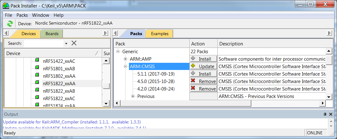

    Have you checked that you have installed the ARM CMSIS pack in Keil Pack Installer?
    image description
    This should provide the missing file (core_cm0.h), and it should be located in the following path:
    {Keil_install_dir}\ARM\PACK\ARM\CMSIS\{version}\CMSIS\Include
    If you have the pack correctly installed, you should check that the file can be found in the path.
    Jørgen
