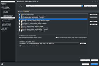

    Please make sure to enable CDT ARM Cross Built-in Compiler Settings in your project properties:
    and that __GNUC__ is included here:

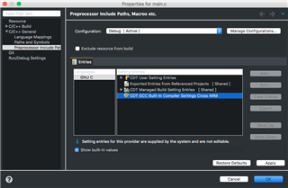

  • Hi Martin,
    I just checked and the entry list in CDT ARM Cross GCC Built-in Compiler Settings is empty. I do have it "checked" but in the Entries menu it doesn't show anything.
    Please make sure to stand at "source code level":
    Then make sure to check "CDT GCC Built-in Compiler Settings Cross ARM:

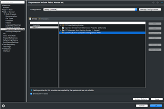

  • Hi Martin,
    I do have the CDT GCC Built-in Compiler Settings Cross ARM checked, but somehow there are still no entries there.

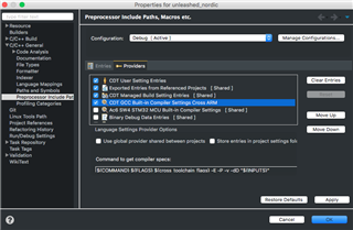

    I checked in another project and the entries are there, but for some reason in this project there are none. Do you have any idea how to solve this?
    The settings are checked like this on a project level, at source code level I don't see that menu:
