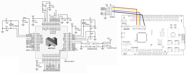

  • I've connected the target board to the debug output of Nordik DK 400150 to make sure the issue is not cause by the J-link. The target board is supplied with an external 3.0V

  • Please take a photo of your setup. Make sure you connect the Vref pin to the DK. I suspect there could be a problem with the SWD connections or the power of the chip.
    Usually, you won't be able to brick the chip by just flashing softdevice or application to it.
  • See the picture below on how it is connected. The chip is externally supplied wit 3.3V on the VCC.
