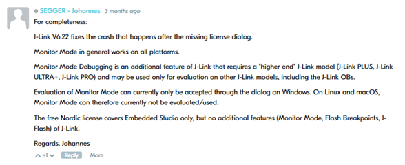

    Finally, from your screenshots, you appear to be using ubuntu/linux as your development platform and there are licensing issues which you would need to be aware of (since the on-board nrf52x jlink MMD evaluation only covers Windows I believe). Please review the following link to determine your requirements on that front. (https://devzone.nordicsemi.com/f/nordic-q-a/27363/monitor-mode-debug-w-nrf52840-ses-3-3-sdk14-1-0-ble-s140/108073#108073)
    Post back if you need any additional details on the MMD front or clarification of the above.
