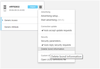

    SteveHx said:
    Step 1 works. When I connect, I can't even get to the bonding at step 2, because even my fast fingers can't get there before it decides to reject me. When I first tried this, it would at least let me make the selections and click the final "Pair" button before tossing me out on my ear, with the same errors.
    This suggests that you have deleted the bond information in nRF Connect, but not in your application.
    SteveHx said:
    <info> app: Connected to a previously bonded device.
    Your device tries to connect to nRF Connect using the keys stored when you bonded the device. This information is deleted in nRF Connect, so the connection is dropped.
    Try erasing your board, download the application again, delete any bond information in nRF Connect and try again.

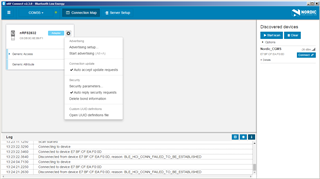

  • It sounds like you've hit the nail very precisely on the head, and I have some reading to do. That's exactly what I was asking for, some pointers to cut thru the mass of documentation. One remaining unclear item: You mention a need to erase my target board as a separate step from writing the firmware to it. I would expect, based on many dozens of device programmers that I've used in the past 4 decades, that the J-link would by default erase before programming, and would require special steps to avoid that erase step. I'm running it from within Visual Studio, which hides most of such details. How would I perform the "erase" step that you describe?
  • And I'm sorry to keep repeating as well. As I've asked before, how do I delete the bonding information in the dev kit, so that I can delete it on both sides and start afresh. According to what you've told me and what I've observed, just reloading the firmware with a new build does not seem to do it.
    I will switch back to using the desktop version of nRFconnect as you suggest adn see what progress I can make there. But ultimately I need to show the client a reliable way to connect with their iPhone(s).

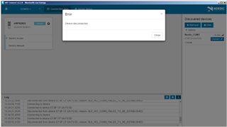

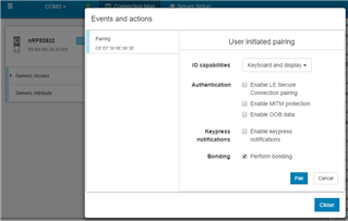

  • I have now come full-circle. I took your advice to go back to basics, run the example exactly as instructed. Am I using the correct instructions, as shown under Testing back up at the start of this thread? I compile, download, and run a pristine copy of the CGMS app. I start nRF Connect on the PC. In step 2 I am supposed to Bond by starting at the Settings button for the device. There is no such button that I can see. There is a starburst thing on the host device, and when I click it and select "Security parameters", that seems to open a settings dialog, the only thing I can find that is remotely close, like this:
    Since I am supposed to be Bonding, I turn on "Perform Bonding" and then "Apply". By now the CGMS app has timed out from advertising, so I press Button 1 on the dev kit to restart, then click Connect on nRF Connect. That yields
    You can see the error log in nRF Connect in the screenshots. Here is the log captured from the device via the serial port:

    1. I erase my nRF52-DK using nRFgo Studio, because simply re-flashing the example might not erase any encryption keys present.
    2. I erase any bond information in nRF Connect.

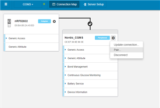

    4. When I observe that the DK is advertising, I start the scan in nRF Connect.
    5. Connect to the device advertising as Nordic_CGMS and then pair/bond (see pictures below.)
    After that, the example works just as expected, and the connection is stable.
